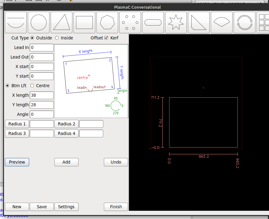

The conversational tool is so cool now!
A few things I noticed about conversational:
1. The preview is in Metric
2. Over Cut check box cant be checked in the circle mode (stays greyed out)
3. The Conversational window stays on top of everything.. including this Google Chrome window :)
4. Y start starts at "-0.000" for at least rectangles. Probably doesnt make much difference but was just noticed it
5. I asked it to offset by the kerf width, but the produced code does not offset by kerf width for a rectangle.
The following options:
Produced this code:
Thrown in at the deep end! And you thought you were just going to change the temperature in your car!
I think its Phill's cunning plot to outlaw dinosaurs!
02 Aug 2020 00:14 #176829 by phillc54
Replied by phillc54 on topic Feature Request
I didn't know there was another system...
Oops, I totally forgot it, easy fix.
It is only enabled when you set an internal cut and the diameter is smaller then your small hole diameter setting.
I didn't want it able to hide behind the GUI and to do that it needs to be on top of everything (I think, i'll search some more)
It is 0.000 here, maybe when I fix it for that odd units system then it will be better. :)
I can emulate that here, it does work if you have a leadin. I probably should disable offsets without a leadin.
"Nice to have" improvement idea... Can the pictures change with the settings? For example inside vs outside. Also, Start point (bottom left vs center)
They could but it would be quite a lot of work. All those images are drawn in CAD (QCad for me), the master is saved as a dxf and the images are exported as png. So it would require an image for each setting plus all the python code to do the changes.
I found it a bit confusing that I told it a start point of 0, 0, but it really started half way across the bottom leg of the rectangle (0, 19). I understand now what is going on, but maybe "zero point" or something is more prudent?
The points are related to whatever the coordinate system was when you opened the conversational.
At the end of this cut I received a Joint 3 following error. Joint 3 is my Z axis. I don't understand why it would have a following error because the THC is supposed to have been disabled and therefore the Z axis should not have been moving at all?
Well Z does have to move for probing, pierce height, cut height then finish height. I don't understand why you would get a following error though.
Maybe one place to look is HalMeter? I know that stays on top of LinuxCNC no matter what, but it doesnt intrude on any other windows. Truly only an issue when I'm trying to test and type to you on here at the same time :silly:
haha you know I'll catch it if it doesnt! :laugh:
Why would one only want a kerf width offset when using lead-ins?
I figured as much. I may at some point in the future feel like volunteering to create them all, if you're interested. If you're not, that's ok too, I know it's likely a lot of coding.
I dont quite follow here. Before I opened the conversational, I set my 0,0 point. What I'm saying is rather than actually starting the cut at 0,0, it actually started the cut at 0,19. I think it's semantics on the word chosen, You're asking for the location of the zero point, but that is not where the torch will actually start.
Oh, finish height! That makes sense. It never did return to finish height at the end of the cut. I did a little research, and Andy at one point told someone that following errors are usually a result of the servo thread not being fast enough. He suggested they calculate the frequency for the axis and compare to the thread and go from there. I understand what he's saying, I think. I will have to dork around with the calculations. For now, I slowed the axis down. 440ipm for Z is probably way faster than necessary. So I set it to 300 and chopped the acceleration down to 40.
One last thought: It wouldnt have anything to do with the arc-ok being overridden would it?
02 Aug 2020 01:15 #176835 by phillc54
I sure do. :)
With the exception of circles all the kerf offset code in conversational uses gcode cutter compensation:http://linuxcnc.org/docs/2.8/html/gcode/g-code.html#gcode:g41.1-g42.1
Conversational is meant to be "quick and simple" and not a replacement for CAM. So I chose to do it this way as it keeps my coding simple and much shorter. To use cutter compensation it requires a leadin move greater the tool radius (in our case kerf width).
Yeah, we could have a look down the track.
I get what you mean now. So I should rename X start and Y start to X origin and Y origin?
It "shouldn't"...

02 Aug 2020 01:45 #176841 by snowgoer540
Replied by snowgoer540 on topic Feature Request
Oh, right, I actually recall this now from other things. Makes sense. To your point, if kerf offset wasnt an option, you could always manually do it, especially in the case of a rectangle by just making it undersized. I think it's sufficient to grey it out when it does not apply. I completely understand wanting to keep it simple.
Sounds good. I'll make note of it somewhere and see if it comes up again haha
I think that might be more appropriate, yes.
It "shouldn't"...
I'll be cutting some tomorrow, I slowed the axis down, I guess I can see if it does it again. But now that I think about it, I cant hardly believe that 440 ipm was too fast, especially when the others are moving at 1200 with more microstepping.
I'll probably be up for another hour or so if you need any clarification on the Mesh Mode (MM) and CR posts at all.
02 Aug 2020 02:12 - 02 Aug 2020 02:15 #176844 by phillc54
I see the -1 here but it picks that up from the preview screen, notice the same on the preview so I don't think I can do much about that. Oops, I am obviously not thinking while I type...
Note the dinosaur units. :)
What about something like this:
