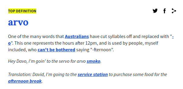

Made me work for that one... I learned arvo = afternoon.
Urban Dictionary told me:
Is -o ing words really a thing? That sounds like in the New England states here (especially Massachusetts) where they add an "r" to some words, but take it out of others.
