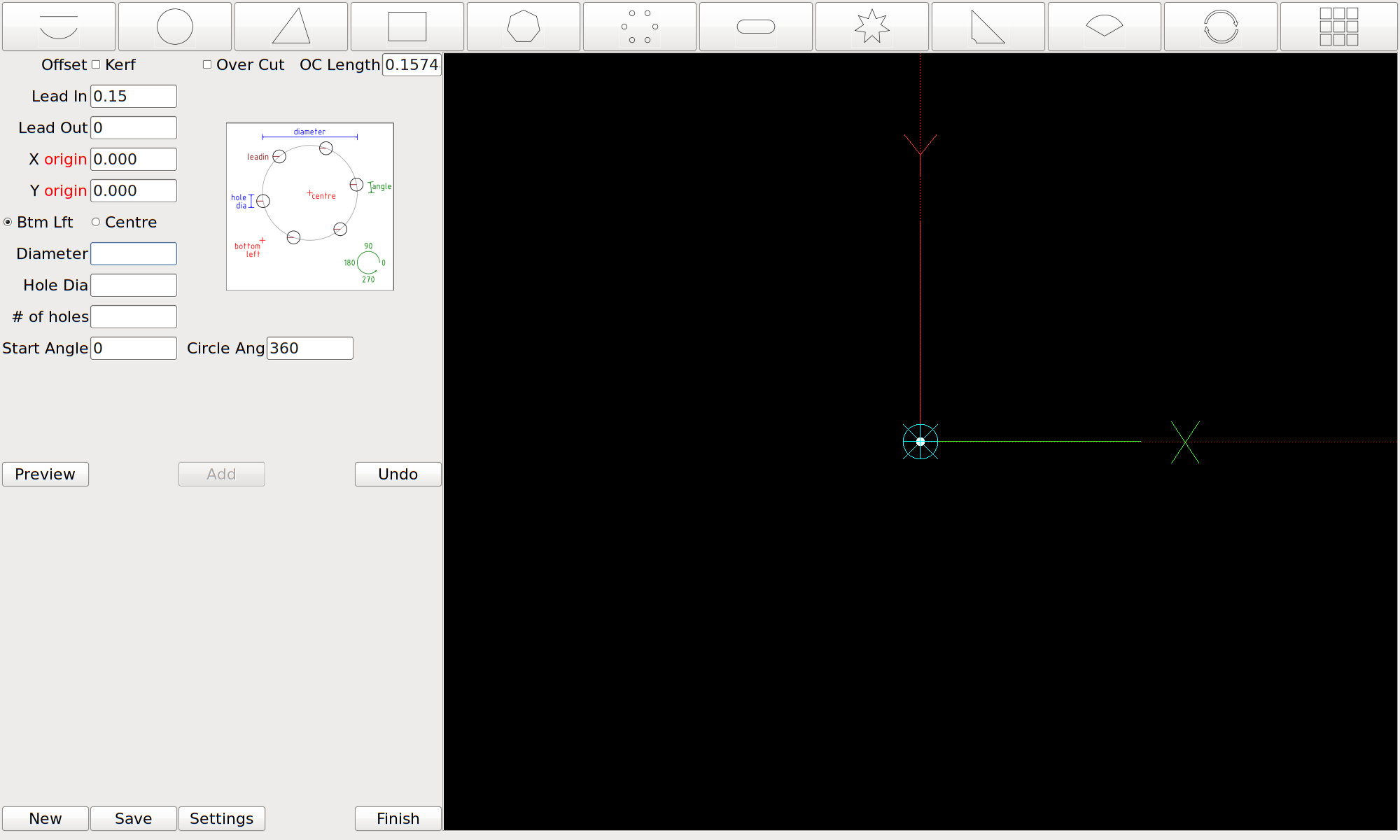

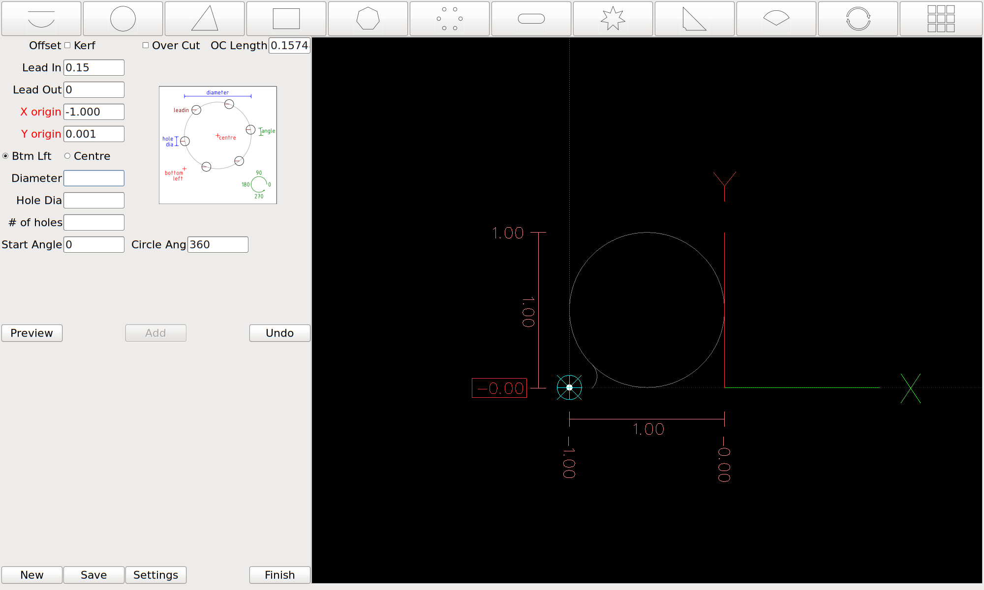

I see the -1 here but it picks that up from the preview screen, notice the same on the preview so I don't think I can do much about that. Oops, I am obviously not thinking while I type...
Note the dinosaur units. :)
What about something like this:
What I was seeing was -0.000 for the Y value.
I think that works, looks good to me!
02 Aug 2020 02:27 #176847 by phillc54
Replied by phillc54 on topic Feature Request
I realised that after I posted :S hence the edit
You don't think the red is too much?
V2:

02 Aug 2020 02:43 - 02 Aug 2020 02:43 #176849 by snowgoer540
Replied by snowgoer540 on topic Feature Request
V2:
I like that “origin” Is the same color as the words “centre” (whatever that is :laugh:) and “bottom left”. So the picture corresponds to the input field description. I like V2.
Last edit: 02 Aug 2020 02:43 by snowgoer540.
02 Aug 2020 02:45 #176850 by phillc54
Being at the bottom of the world we need a different one to you guys. :)
