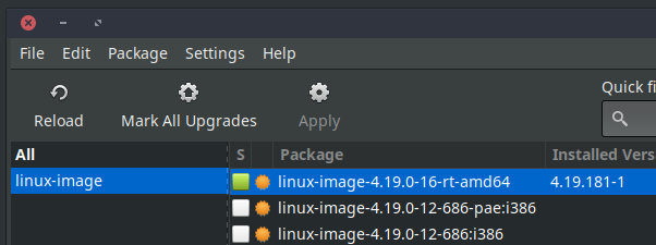

20 Jul 2021 02:52 #215362
But can't find anything about preempt_rt in Synaptic
What should I look for?
Replied by rodw on topic Why is Plasmac and QTplasmac pausing at the end of a cut for no reason?
Any more clues on this? I've installed MX Linux MX-19.4.1_x64 “ahs”MX-Linux has the preempt kernel in the standard packages so it can be easily installed from synaptic or apt.

20 Jul 2021 03:12 #215363
by phillc54
Replied by phillc54 on topic Why is Plasmac and QTplasmac pausing at the end of a cut for no reason?
- Posts: 12172
- Thank you received: 4154
20 Jul 2021 03:53 #215366
Thanks Phil, That worked but the next challenge is installing the key without a user ID
This must be new. Any ideas?
$ sudo apt-key adv --keyserver hkp://keys.openpgp.org:80 --recv-key EF1B07FEE0EE663E
Executing: /tmp/apt-key-gpghome.VIuCqsavWb/gpg.1.sh --keyserver hkp://keys.openpgp.org:80 --recv-key EF1B07FEE0EE663E
gpg: key EF1B07FEE0EE663E: new key but contains no user ID - skipped
gpg: Total number processed: 1
gpg: w/o user IDs: 1
