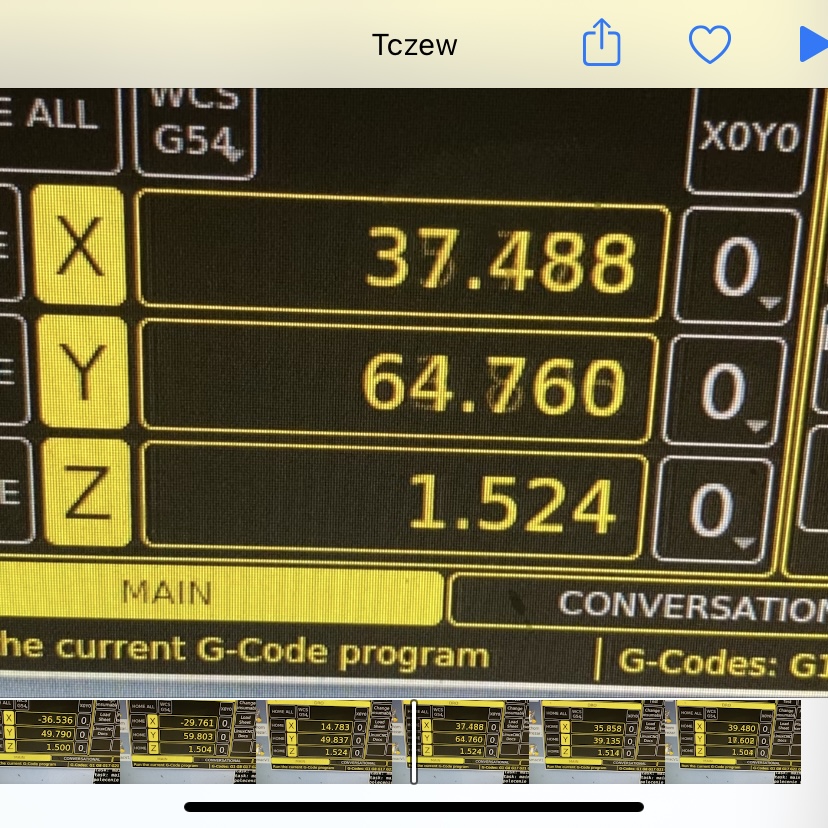

wrong scale thc of the z axis during cutting on qtplasmac

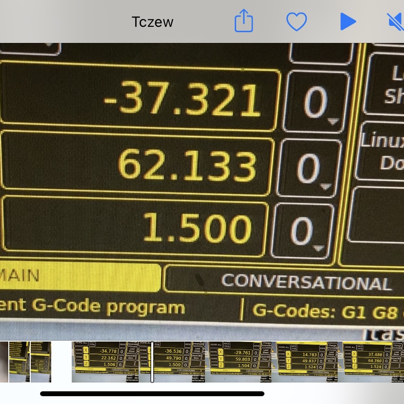

07 Jul 2021 05:50 #213937
by sibista
Replied by sibista on topic wrong scale thc of the z axis during cutting on qtplasmac
no, while thc tells the torch to go up or down, the torch moves up and down but only in hundreds of millimeters, not even a millimeter will go up or down. sorry for english greetings

07 Jul 2021 07:13 #213942
by sibista
yes, even up to 1000, nothing was done

07 Jul 2021 07:17 #213943
by phillc54
Replied by phillc54 on topic wrong scale thc of the z axis during cutting on qtplasmac
What is the value of Setup Speed?
Can you post a backup of your config.

07 Jul 2021 11:06 #213959
Replied by tommylight on topic wrong scale thc of the z axis during cutting on qtplasmac
Missing
Plasmac.thc.feed-rate ?
I have it posted here on the forum somewhere but am on the phone.
