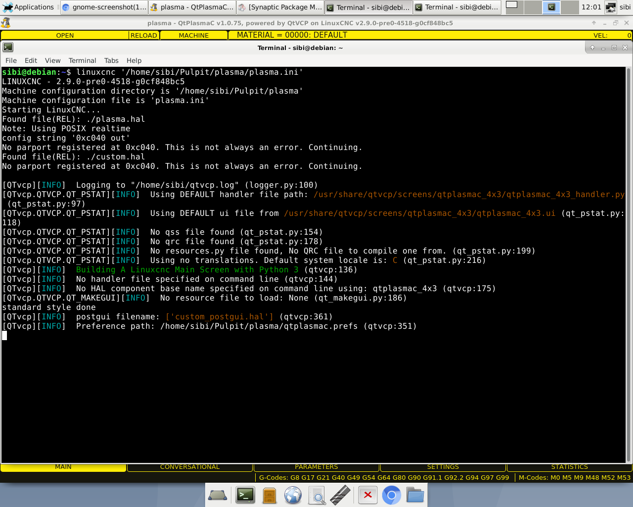

Hi
The move up and move down pins work, the led up and mi led down pins do not change. Pin thc-feet-rate has a value of 1425. I'll check with a real cut.

Before, my simulation worked and there was a movement of the Z axis. I turned on the burner and now it is ok. I do not know why it did not work before the Z-axis body. I reconfigured everything from scratch, I switched to English and everything is ok. Now I will go back to Polish and see if it works. Thanks for the help.
