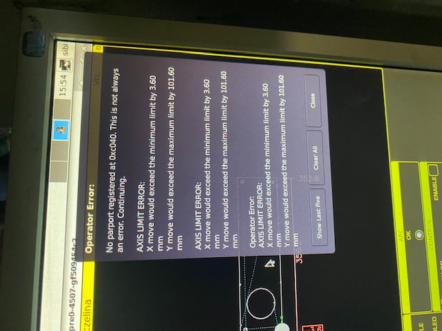

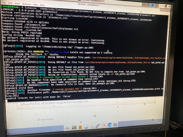

Hello .
I did not notice this post 42524-important-notice-for-plasmac-users
Now I get the error
Error is also how I use the shape library
Now I get the error
- snowgoer540
- Posts: 2580
- Thank you received: 907
26 Aug 2021 14:07 #218801
by snowgoer540
Replied by snowgoer540 on topic wrong scale thc of the z axis during cutting on qtplasmac
Can you describe the exact steps to reproduce the base 10 error?
The second error is telling you that your G-Code is outside of the movement boundary for the table. It would be helpful to see the entire screen, but moving your origin (x0y0 location) should solve the issue, assuming you have enough table travel.
Thanks for the update, you'll have to wait for Phill on the THC one.
I was looking for the steps to reproduce how you got the error "invalid literal for int() with base 10: 'False'" in the terminal.
- Posts: 21958
- Thank you received: 7478
26 Aug 2021 15:13 #218811
Replied by tommylight on topic wrong scale thc of the z axis during cutting on qtplasmac
Seems that was on the prefferences file, so might be edited and "false" put instead of a number.

Hey, this error does not exist anymore. Thanks for the help. I'm waiting for Phil to fix this error. Regards
- snowgoer540
- Posts: 2580
26 Aug 2021 15:32 #218814
by snowgoer540
Ah yea, it seems you're right Tommy. Good catch!
