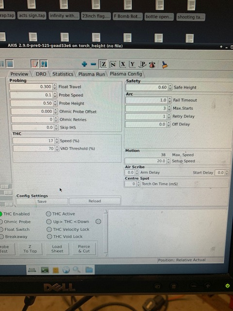

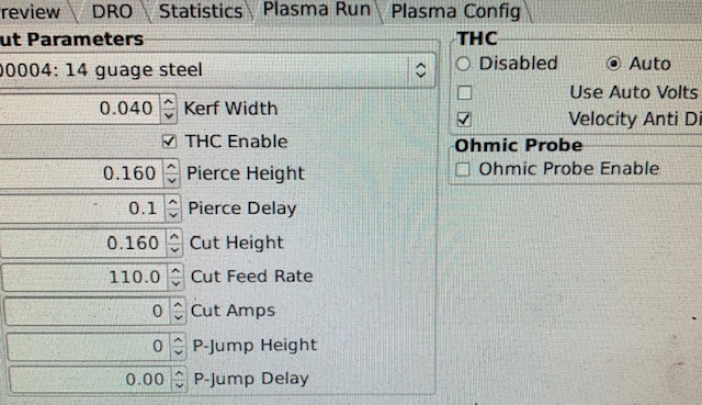

- phillc54
- Posts: 5711
- Thank you received: 2100
20 Apr 2020 01:17 #164772
by phillc54
Replied by phillc54 on topic Machine has been working great but my Proma THC is responding slow when cutting
Does it go back up after a while?
Are there any error messages?
Can you post a shot of the Run Panel and the Config Panel?
I just saw your last post, you said it went down 1.5510 and is still 1.0 from the material. That is 2.55 and your travel is only 2.0. That does not compute.

20 Apr 2020 01:23 #164777
by TexasCNC
Replied by TexasCNC on topic Machine has been working great but my Proma THC is responding slow when cutting
Yes it goes back up and no error messages well maybe not 1 inch but maybe around 1/2 inch to the surface of material.
- TexasCNC
- Posts: 373
- Thank you received: 10
20 Apr 2020 01:28 #164779
by TexasCNC

- phillc54
- Posts: 5711
20 Apr 2020 01:31 #164782
by phillc54
I think you will find it is working, you are probing at 0.1" per minute try 12" or so.
- TexasCNC
- Posts: 373
20 Apr 2020 01:38 #164783
by TexasCNC
Ok changed it to 12 and did the probe test again and now it started to go slower towards the bottom of the probe but still did not touch material and it went back up.
Do you mean I enter 6 inches on the touch window?
