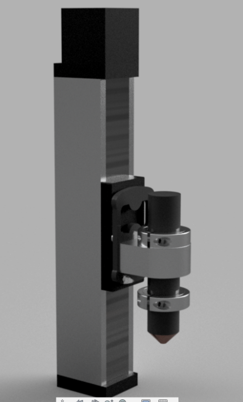

- Posts: 12178
- Thank you received: 4156
01 Jun 2020 01:34 - 01 Jun 2020 01:35 #169614
Hey TexasCNC, assuming you live where you say you do, if you contact me here
www.vmn.com.au/contact-us
I can put you in touch with my associate Marshall in Houston.
We are working on a complete assembled controller package based on Mesa hardware and Plasmac. All the hard work regarding carefully engineered motor selection is done. As of today, the Z axis is finally designed so it will all come together quickly from here. We have a few presales ranging from complete tables to retrofits to just the control package.
The first one happened when we had half a circuit board designed, the next was when we had a half a gantry designed but now we have a complete Z axis
Replied by rodw on topic Machine has been working great but my Proma THC is responding slow when cutting
Can you point me to the correct hardware I need to somewhat make it easier in using mesa electronics? As far board and THC and ohmnic sensing? What cards are needing and what configuration I am going to need to get this working. I can probably get started on a new build I am looking at making my table bigger and I want to use something that everybody is using or popular in using?
