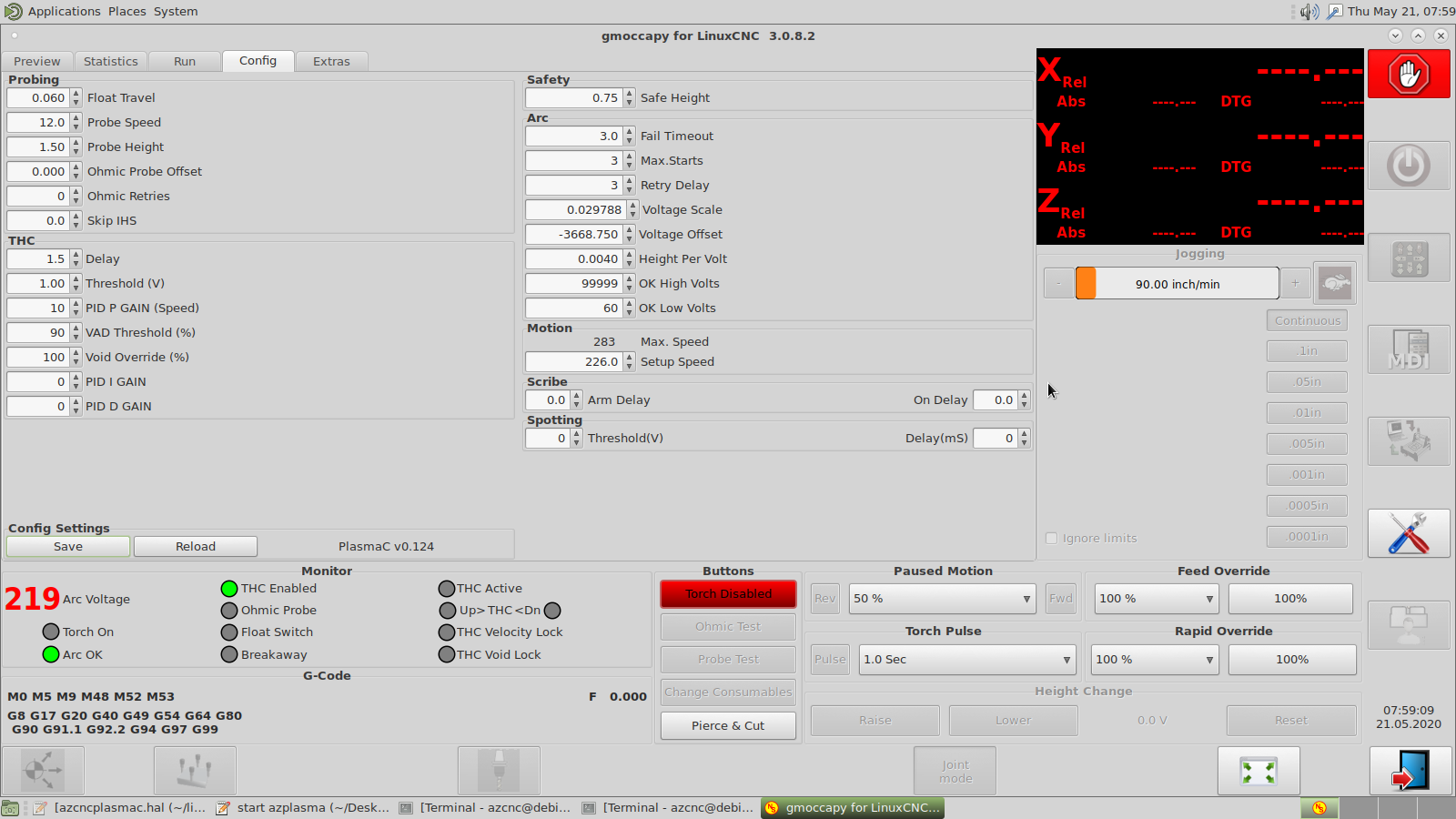

So with this build. I have my mode 0 with a scale 0.01985851 and offset 3668.7500.
like i posted before Voltage reading jumps from -00 to 000 and arc ok on the screen goes on and off , along with ohmic test button.. I can pulse torch on and off. but when i go to run a test cut I get arc ok lost error. and this is where I'm stuck

<commandline>:0: pin or parameter 'plasmac_run.cut-type' not found

For some reason Gmoccapy is trying to load "imperial_squares.ngc", you need to edit "az_cnc_plasma.pref" so:
open_file = /home/azcnc/linuxcnc/nc_files/examples/plasmac/imperial_squares.ngc
just reads:
open_file =
You cannot open files on program load with PlasmaC as all the required HAL pins are not yet established.
The next thing you need to change is Arc OK Low, a starting point for that is around half of your expected cut volts. You can tune it later if you wish.

[quote
The next thing you need to change is Arc OK Low, a starting point for that is around half of your expected cut volts. You can tune it later if you wish.[/quote]
my current arc ok low is set to 0 would that not be achieve the same as of half of the expected cut volts as you suggested?

18 May 2020 14:37 #168155 by tommylight
Replied by tommylight on topic Z axis
That is why the ARCOK is going on and off all the time, it should be set at something like 60 to 80V.
It will behave like Tom said. The slightest bit of noise would give an Arc OK then if the noise disappears then you will get a lost arc.

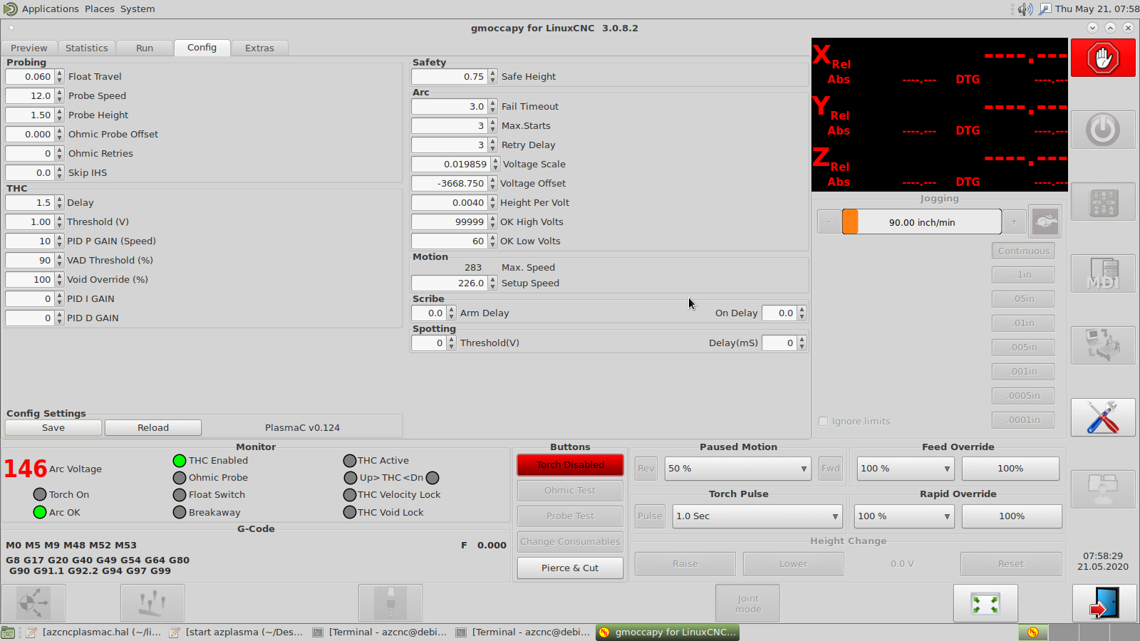

21 May 2020 15:04 #168494 by motal2004
Replied by motal2004 on topic Z axis
So i started over & set the low volts to 60.
at a scale 50:1 i get a reading now 143 and if at a scale of 75:1 i get 219 see attachment.
21 May 2020 23:47 #168554 by phillc54
Replied by phillc54 on topic Z axis
Well 50:1 seems closer than 75:1. Is it possible to measure the arc voltage with a meter while you observe the arc voltage on the Axis GUI.
Time to create page: 0.141 seconds
