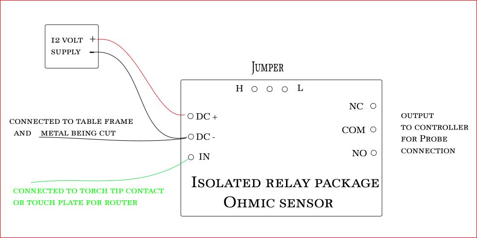

01 Aug 2021 02:21 #216574
by acourtjester
Replied by acourtjester on topic New Project with Mesa 7I96 and THCAD-05
Ok now I wanting to know about this that you said
the plasmac.ohmic-probe pin is a generic probe pinout, it can be used by relay (which is what I use)
Would you share the circuit????
this is what I am using on my other table, very simple and works great, water shorts it out sometime, I just dry it and go on.

01 Aug 2021 02:47 #216575
by phillc54
Replied by phillc54 on topic New Project with Mesa 7I96 and THCAD-05
I have some preliminary docs that I started, I'll put something together tomorrow.
- Posts: 12161
- Thank you received: 4151
01 Aug 2021 06:47 #216584
I had a look at the component source code in git hub.You do need to add the line Phil Suggested:
I think you need to press the Probe Test button in QTplasmac while pressing your switch before the LED will light up in the gui. Make the change above and see how it goes when you press the Probe Test..
I'm sorry, but it seems the example in the docs for ohmic.comp is missing some hal lines in the example. I'll try and get that updated.
I think you are so close, there is no point using your relay just yet. The Plasmac ohmic probing is designed to be used with a couple of relays so you might not just be able to use your circuit without modification.
Replied by rodw on topic New Project with Mesa 7I96 and THCAD-05
If arc-on is going to yellow, then its all wired in OK!Ok with the 3 lines in the custom Hal QTPlasmaC starts When I look at the Hal show for the Ohmic sense values the attached screen shop will explain what happens. The Arc-on changes from red to yellow when the switch is pressed.
net plasmac:ohmic-enable ohmicsense.is-probingI think you need to press the Probe Test button in QTplasmac while pressing your switch before the LED will light up in the gui. Make the change above and see how it goes when you press the Probe Test..
