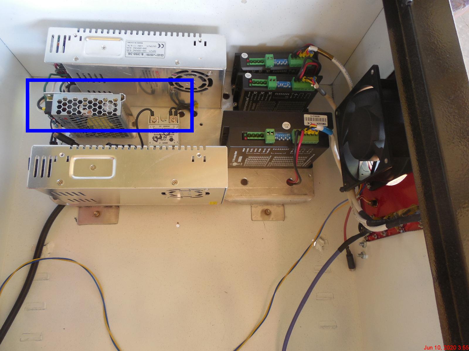

Not sure if I can get to the power supply at this point as it is below the shelf that has the 7I76E and THCADs.

03 Aug 2021 11:10 - 03 Aug 2021 11:41 #216800 by snowgoer540
Replied by snowgoer540 on topic New Project with Mesa 7I96 and THCAD-05
Assuming the blue box'd power supply in the picture is the one you are using for OHMIC, then it looks like it is not an isolated power supply (it looks like it has a ground hooked up to it). Further, if it has a spot to hook a ground to it, then it definitely is not the double insulated isolation class II type power supply that is recommended. This is dangerous.
