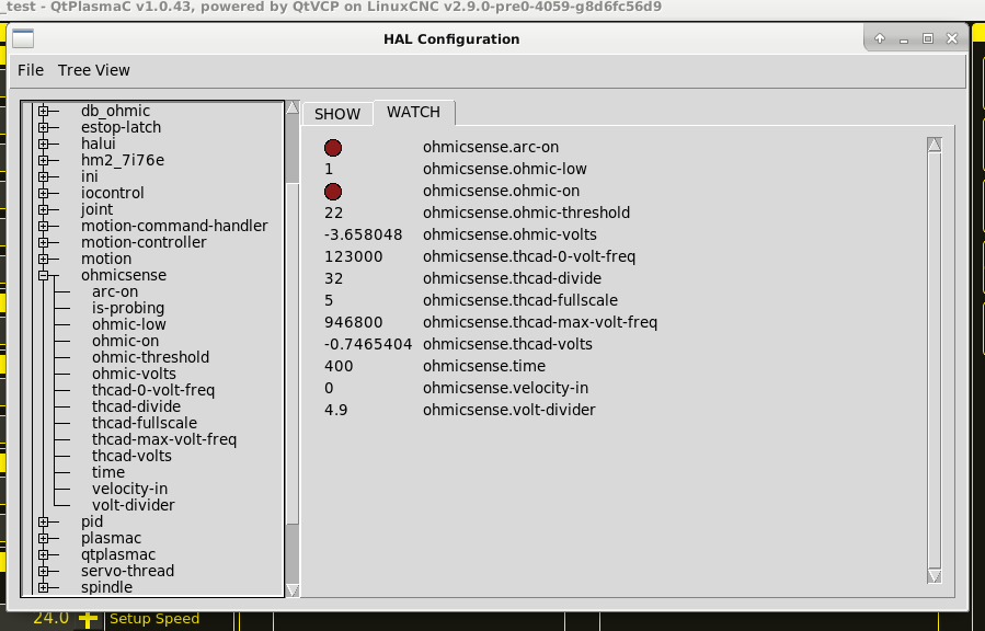

The fist pic seems to indicate that the ohmic component has not loaded.
You can access encoder B if you select the corect firmware in the Configuration Page shown in the second pic. It wont help though as ohmic is not included in PnCconf.
ohmic-enable would normally be used to turn on any relays used to enaable ohmic senseing, I don't know if the ohmic3 component uses it or not.
Can you post your current machine and custom hal files.

The ohmic3.comp should be loaded per the loadrt command in his custom.hal
The ini file shared showed that custom.hal was being loaded.
It should be named ohmicsense by that file.
As with any missing pin, comment the offending line out, and review halshow to check the component is loaded and what the pin name is.
Ohmic3 does not need the ohmic-enable signal

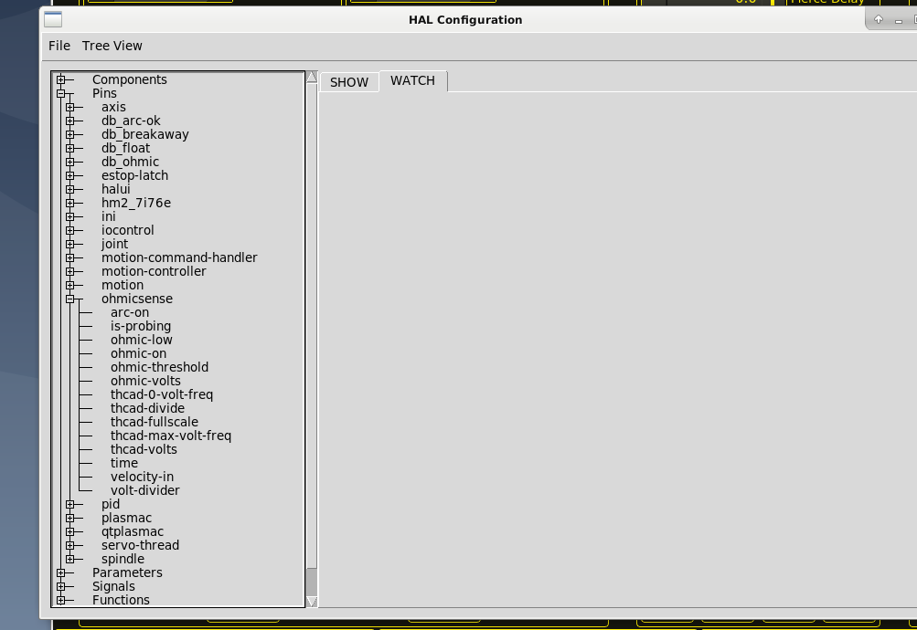

Can you open halshow then open the pins part of the tree and confirm ohmicsense exists?
If we get that far, can you then open the ohmicsense tree and share a screen dump of its pins?
forum.linuxcnc.org/38-general-linuxcnc-q...-05?start=290#212684
A link was provided to this post where it could be downloaded
forum.linuxcnc.org/plasmac/38848-hyperse...ons?start=210#175839
From what I could see you installed all of this because I would have expected an error about ohmic3.comp not found before the pin was not found.

It is kinda convoluted, the plasmac.ohmic-probe pin is a generic probe pinput, it can be used by relay (which is what I use) or by ohmic or ohmic3. This pin is fed from a debounce component, the input of which is db_ohmic.in using a signal named plasmc:ohmic-probe.
I thought you were using ohmic3 but you are loading ohmic in custom.hal
linuxcnc.org/docs/devel/html/man/man9/ohmic.9.html
You seem to be missing these two lines from custom.hal:
net ohmic-vel ohmicsense.velocity-in <= hm2_7i76e.0.encoder.01.velocity
net ohmic-true ohmicsense.ohmic-on => plasmac.ohmic-probePlease Log in or Create an account to join the conversation.
