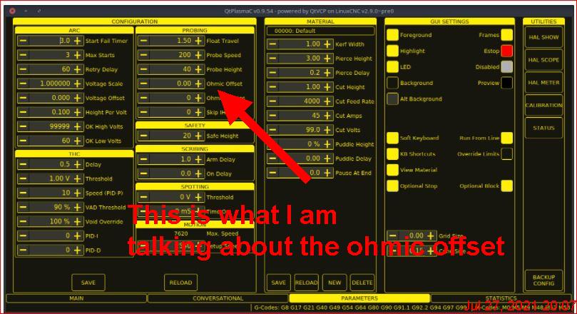

I saw your one arrow is pointing at the "-2" for the arc voltage. If this bothers you, you can set a window for which the GUI will display 0 and not fluctuate. This wont affect normal cutting. That is explained here: linuxcnc.org/docs/devel/html/plasma/qtplasmac.html#_zero_window

28 Jul 2021 01:12 #216090
by acourtjester
Replied by acourtjester on topic New Project with Mesa 7I96 and THCAD-05
Sorry guys it seems my image was not clear enough. The top arrow with to point at Arc OK and the lower one was for Ohmic sensor indicators. Voltage display not a worry as I did see the expected volts with the 9 volt battery attached. I did have the ohmic box lit when I was trying to get an indication. And it did not show in Hal Show. I am using a micro switch in place of the torch tip and metal surface, switch closed = tip on metal. There is box on the parameters page that is for ohmic offset, that is what I thought needed a value in place of the 00.0 that is in there now.
- phillc54
- Posts: 5711
- Thank you received: 2100
28 Jul 2021 01:15 #216091
by phillc54
Replied by phillc54 on topic New Project with Mesa 7I96 and THCAD-05
You only need to adjust that if probe testing setup shows the height as incorrect. This is to compensate for any debounce delays etc.

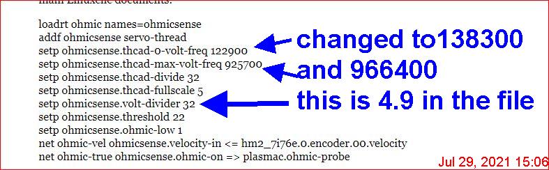

29 Jul 2021 20:21 #216263
by acourtjester
Looking to find something I checked the input to the THCAD-5 with the switch closed shows about 19.4 volts. Looking at the write up for the Ohmic circuit attached below. the values for my board are in the file. I don't know if this is something but the voltage divider in my file is 4.9 and the write up show 32??
