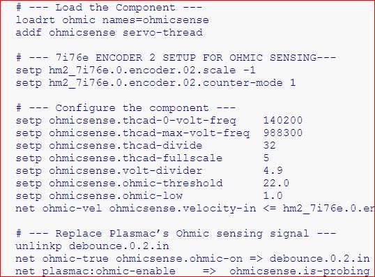

Hi Phillc
Here I am again with my hat in hand, I tried to progress in the next step of configuring for Ohmic sensing and THC. I tried to copy the info from the manual in to the Hal file and it did not go well. Either I put it in the wrong place or it conflicted with other lines. Happy to have the files backed up so am back where I started. I have attached the INI. Hal and the Show Error file for you to look over, any help is appreciated. Also what I tried to copy into Hal from the manual. I did make the change from encoder 2 to 1 Per Rod's info
Thanks Tom
Thanks Tom

You would be best served having custom hal code in custom.hal rather than your main hal file, that way your main hal file can still be changed by pncconf.
You seem to be missing the loadrt and addf lines.

No worries, you will get there. I didn't read the instructions for ohmic so I didn't know.
Basically I was saying that it is best not to modify the machine hal file that PnCconf creates so that you can modify it later ith PnCconf. So keep all custom changes in the custom.hal file which doesn't get overwriten by PnCconf.
The two lines I referred to are the first two uncommented line in the zip file you posted, they should also go in the custom.hal file. So that entire zip file contents should be custom.hal.
the lines:
needs to be changed to:
The "debounce" refers to the old PlasmaC configs, and was changed quite some time go.
the lines:
unlinkp debounce.0.2.in
net ohmic-true ohmic-sense.ohmic-on => debounce.0.2.inunlink db_ohmic.in
net ohmic-true ohmic-sense.ohmic-on => db_ohmic.in

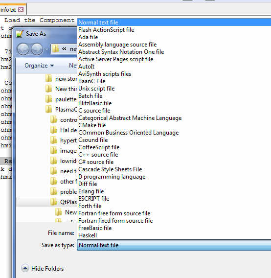

Thanks again for the reply with updated info. Attached is a notepad file which shows the changes to the infor for the Hal custom file. Showing the change to encoder 1 and the setting from my THCAD freq values. And at the bottom shows what is currently in the Hal custom file. Do I add info to the file or remove the lower info and have just the added info??
Interesting note I use Notepad++ to look at the files on my house PC, well making changes with that do not carry onto the Linux PC, so now I make a notepad file with any changes move it to the Linux PC to copy and paste on the linux PC files.
Last edit: 21 Jul 2021 14:34 by acourtjester. Reason: adding info

Here is what that line actually had in it, there may be a translation error for special characters from Notepad to Linux. That had be talked about on Plasma Spider about DXF file from on software package to another.
# --- Replace Plasmac’s Ohmic sensing signal ---
Also here is a list of the formats that Notepad++ will save files in.

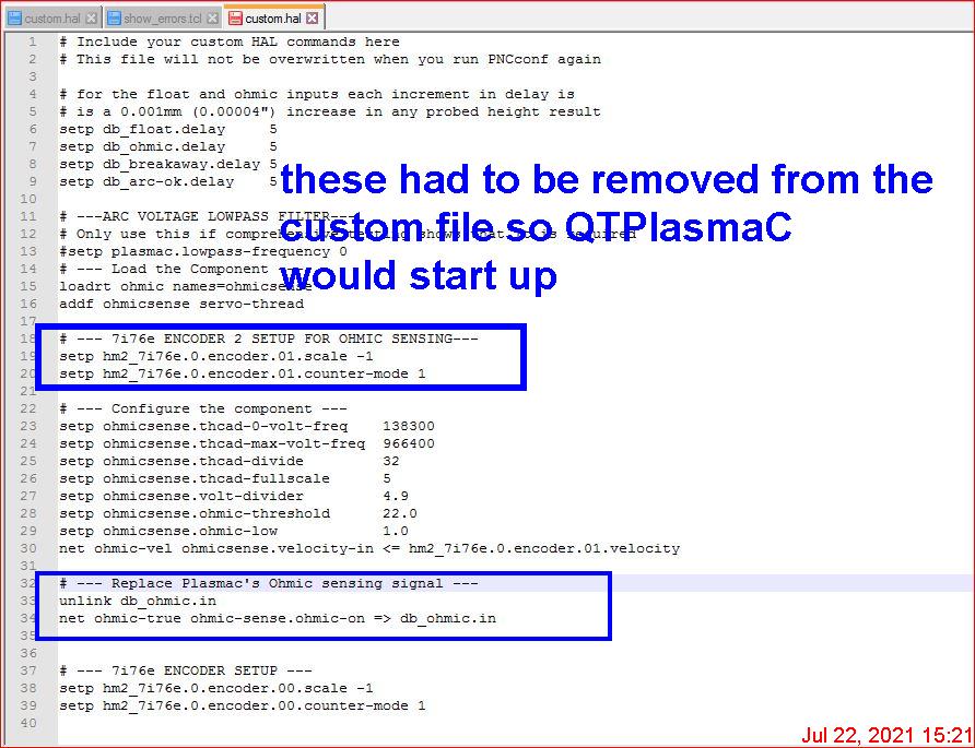

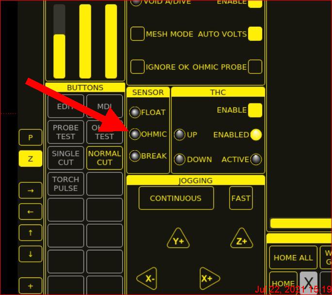

22 Jul 2021 20:42 - 22 Jul 2021 20:49 #215615
by acourtjester
Replied by acourtjester on topic New Project with Mesa 7I96 and THCAD-05
Ok new report, I copied the info to the Custom Hal file, and I then could not start up QTPlasmaC. The error box show a problem with a line in the file I deleted that line. After a few more errors and removing the lines it showed I was back to starting QTPlasmaC I have attached the custom Hal file after the coping in the additional info and an image showing the lines I removed. The Ohmic sensor does not work (I assume the light will light when it does work, image attached). The Float switch does work and show with the float light when activated. I have the THCAD 5 wired to the encoder B is that correct??that is what is shown in the Hypersensing diagram.

22 Jul 2021 23:35 #215619
by phillc54
Replied by phillc54 on topic New Project with Mesa 7I96 and THCAD-05
Do you have the custom firmware file in the 7i76e?
I "think" it is 7i76e_7i76x1_Dpl.bit
