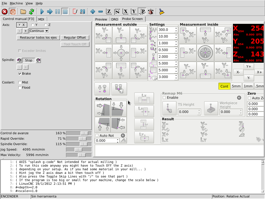

Hi good day.
I have a problem with the probe tab adjustment. I have integrated probe_Screen_v2 in axis (2.7.14), following the guide provided, but part of the icons cannot be seen because they are off the screen.
I have observed all this thread, and in all your installations, the manual control and mdi tab narrows to leave more space to the simulation tab, dro and probescreen. This does not happen in my installation and exceeds the limits of which I know.
I have .axisrc in its corresponding site and also the icons of the resolution size appropriate to my screen, although it smells like this is not the problem.
I hope someone can give me some help on this.
Sorry if it's hard to understand me, English is not my native language
I include a catch that I hope will clarify the problem.
regards

23 Sep 2019 18:06 #145985
Replied by tommylight on topic Work with probe
You are using a 15" screen with 1024X768 pixel resolution, and that is most probably to small for all the icons to show properly.
Get a used 17" or bigger monitor as i do not think there is a way around this, other than shrinking each and every icon.

23 Sep 2019 19:03 #145989
by Samu_97
Replied by Samu_97 on topic Work with probe
problem solved !!
my monitor is 17 ". But in the screen configuration it does not allow to select a resolution higher than 1024x768. I searched google and quickly found how to change the resolution with Xorg.
Now everything looks perfect ...
Thank so much for your help!!!
regards
