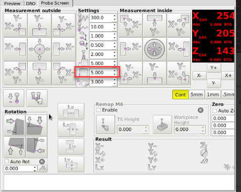

Installed vers.by/ probe :)
Installed Vers Probe sceen on Linuxmint 19.3 "Mate" + Linuxcnc 2.8
First impression / Errors / Bugs / Improvement:
-When starting any touch cycle hiting "ESC"/"F1" keys don't stop the cycle....
-Think it will be better having edge lenght for X and edge lenght for Y so it can center a external rectangle
Replied by MarcoGaspar on topic Work with probe
