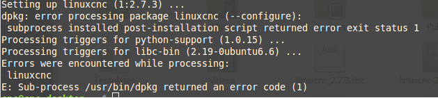

I think der is some weired "package installed by some driver" thing going on. In your mint-emc.txt you write "Install all build depends except libgl1-mesa-dev | libgl1-mesa-swx11-dev:", which was allready installed on my system.
I have an AMD AM1 Athlon x4 5350, maybe this is the problem, dont know.
Had the same error in 17.2 and 17.3 Mate (with and without Codecs)
After installing linuxcnc following your instructions in "mint-emc.txt", linuxcnc starts and runs , but I get an error, which shows up, everytime I do some apt-get stuff in console.
This error is a little bit anoying, but the worst part is, it doesnt allow me to backup my system with remastersys, this error aborts the installation.
I dont know how I get more information to this error, google doesnt help either.

The "post-installation" script is a shell script run by dpkg after a package's files are all in place. The package is still not in a fully-installed state until this script successfully executes.
This script includes some lines hard-coded for linuxcnc, as well as some lines written automatically by "debhelper". Right now there's no information about what step is failing. I believe that you can get debugging output on the terminal if you add "set -x" on its own line directly below the "#!"-line in the file debian/linuxcnc.postinst, rebuild and reinstall the package; or you may be able to directly edit (as root) /var/lib/dpkg/info/linuxcnc.postinst, and then (as root) dpkg --configure linuxcnc to try running the script again.

I installed on all 32 bit processors and your using 64 bit, I wonder if the script is wrong for 64 bit?
The script is installing linux-image-rt-686-pae and I think you need linux-image-rt-amd64. Change the script and try that.

Just a brief not to follow up on my last transmissions. I installed Linuxcnc 2.7.3 on Linux Mint 17.2 Mate and 17.3 mate on 32 bit machines and they work great after I commented out Cam View, as suggested. I then installed Linux Mint 17.3 on my 64 bit machine and then installed Linuxcnc 2.7.3 with the 64 bit kernel. It is also working great and my machine of choice at this time. Thanks again to all those that made suggestions that lead to my success in this venture.
