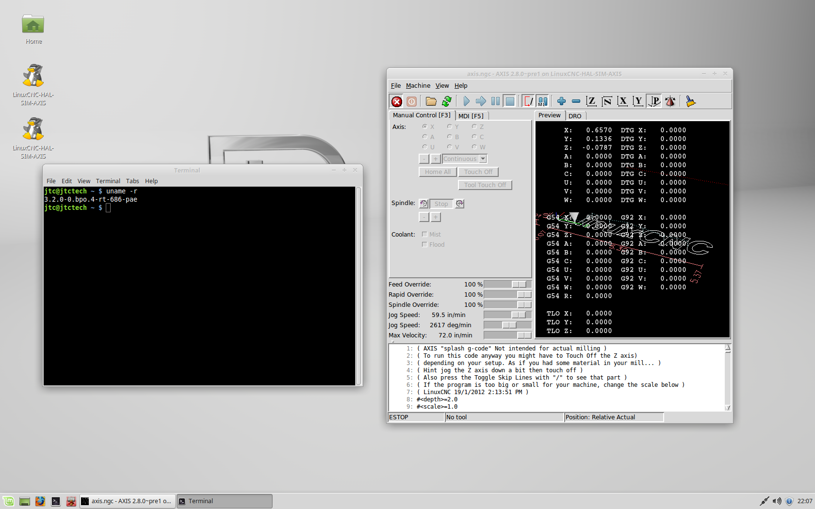

23 Nov 2015 01:29 #65679
Tom
Replied by tommylight on topic Linux Mint with RTAI
just got to having a look at it, thank you very much, will report back.tommylight

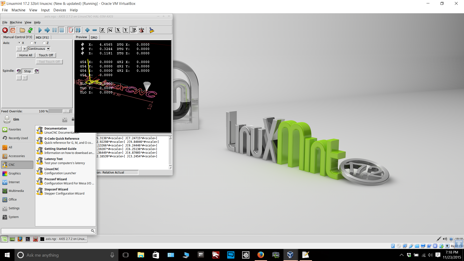

24 Nov 2015 00:38 #65725
by tjmarch
Replied by tjmarch on topic Linux Mint with RTAI
Big John T wrote:
What I'm doing now to build the 2.7 deb is:
git clone git://git.linuxcnc.org/git/linuxcnc.git mint
cd mint
git checkout 2.7
debian/configure -r ; debuild -uc -us > configure.txt
And to install the deb:
sudo dpkg -i linuxcnc_2.7.2_i386.deb
sudo dpkg -i linuxcnc-doc-en_2.7.2_all.deb
Was successful building deb files did in VM ran attached script file
only problem when tried to install using dpkg linuxcnc_2.7.2_i386.deb failed to install dependence problems
Thought I may have did something wrong so did whole process over again
After which I installed deb with right click>Open with Gdebi Package Installer
Gdebi installed a few more packages and install was successful
WhooHoo
Thanks Big John T
keep on share-en please
Tim
