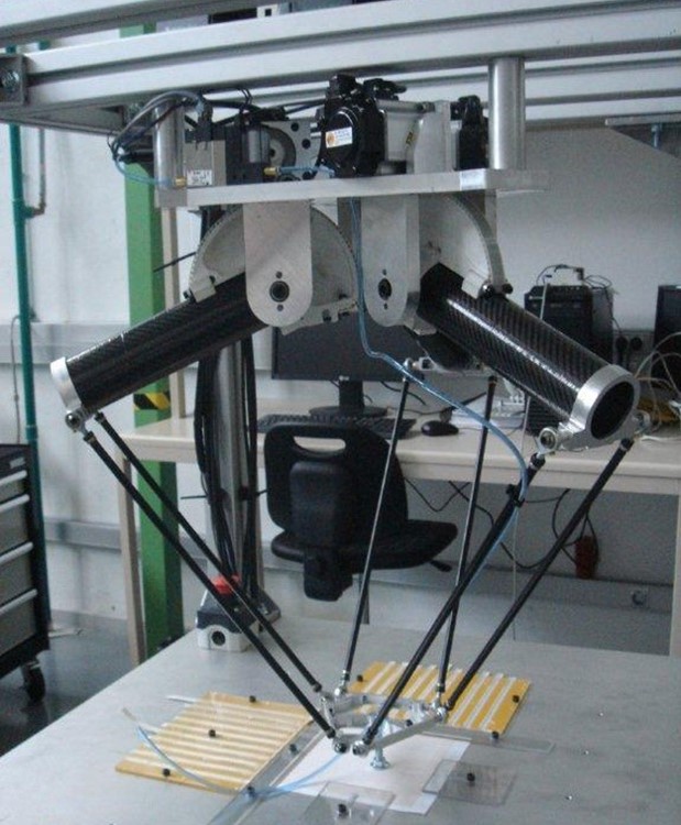

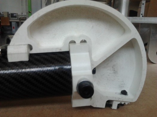

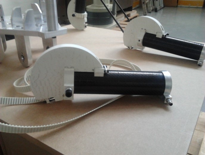

06 Sep 2015 18:45 - 06 Sep 2015 19:18 #62164 by narogon
Replied by narogon on topic Ethercat HAL driver
Beautifull!!!
Can you put some data about universal joints, rods, etc (manufacturer, models, etc)
Best regards
All the mechanics parts were produced by a local manufacturer at Malaga.
I could specify you the materials and the dimensions if you need them.
3 videos of my machine running
Very Nice! Can you show some details of the upper arms and servo drives as well?
I've attached 3 photos. If you need something more tell me.

My main objective was to replace the NJ501 OMRON controller and the use of the Sysmac Studio software with open source software. Due to this is my master's thesis I added some HID to demonstrate the possibilities of EtherCAT interacting with different brands at same time.
The configuration files are uploaded to my gitHub
I used a EL3102 to read the voltage through the joystick and command the halui jog speed of the X and Y axes.
With the EL1014 I monitor the digital switches for the Z axis.
At last I control the vacuum ejector valves with the digital outputs of one servodriver.
I think you could reach your goal with any problem using Beckhoff nodes.
Yes, I used CX-drive to tune the drives. However, maybe you could achieve this sending the parameters at the moment of the transition from PRE-OP to OP mode.
Best regards!!

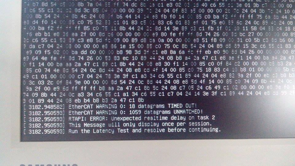

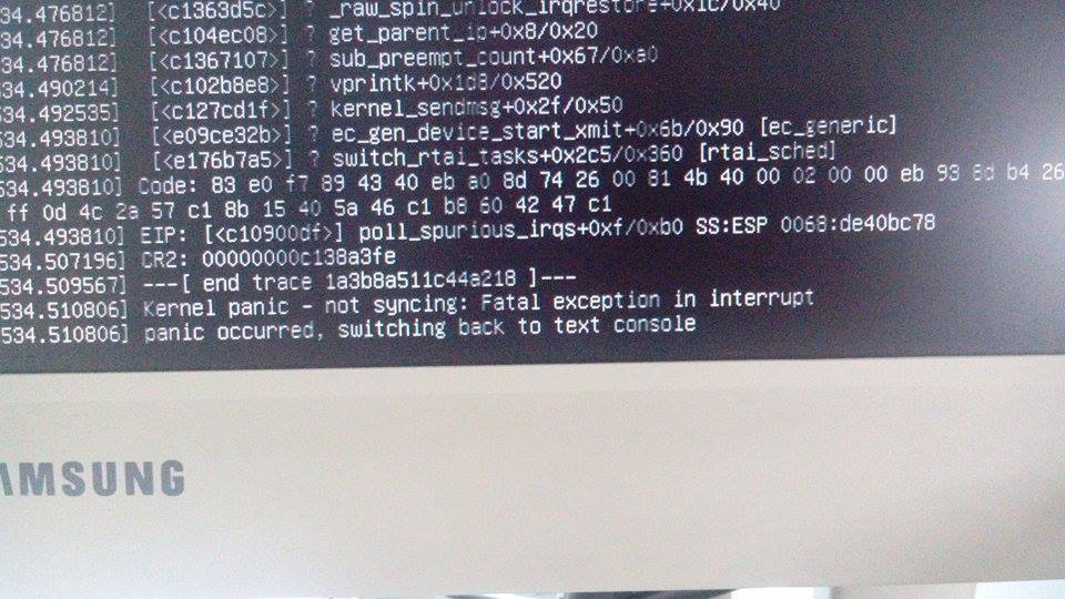

11 Sep 2015 21:07 - 11 Sep 2015 21:08 #62464 by Markux
Replied by Markux on topic Ethercat HAL driver
Hi guys..newbie here, 1st post, nice to meet you all :) .
I recently tried to try the LinuxCNC with Ethercat combo, but I got stuck somewhere along the way so I was hoping to find out exactly where with your help. I should also probably mention that it was also my first month playing around with Linux OS, LinuxCNC and Ethercat, so..it might be that basic chunks are missing in what I do, so I'm sry in advance if the questions are to basic...so, khhmgh :blush: ...here I go:
First of all, here all of the steps I took in order to set up the environment and then I will post the questions:
1. Make a clean installation of Debian Wheezy 2.6 image with a 2.6.4 version of LinuxCNC.
2. Follow the instructions for installing the Ethercat driver described here . Filled in the blanks in the ethercat config file with the MAC address and generic type of driver module. After this modules 'ec_generic' and 'ec_master' are always present in the lsmod list. Commands ethercat master and ethercat slaves seem to be running well.
3. I start LinuxCNC >> open a root terminal >> hal commands of type "show sig, thread, funct, pin" seem to be running well as they display of the corresponding signals, threads (actually just one, the 1ms servo thread), functions, pins etc from LinuxCNC.
4. I prepared a very brief .xml file that as far as I understood should be sufficient for my simple hardware. Here it is:
<masters>
	<master idx="0" appTimePeriod="1000000" refClockSyncCycles="100">
		<slave idx="0" type="EK1100" name="BASE"/>
		<slave idx="1" type="EL1124" name="1124"/>
		<slave idx="2" type="EL2124" name="2124"/>
	</master>
</masters>
5. I run the following commands (:
- halcmd loadusr -W lcec_conf xxxx.xml (the name of the above shown .xml file)
- halcmd loadrt lcec
- halcmd net example halui.estop.is-activated lcec.0.2124.dout-2
- halcmd addf lcec.read-all servo-thread
- halcmd addf lcec.write-all servo-thread (at which the LED on 2124 for dout2 turns on)
after that I get excited :woohoo: that everything works and is all cool, I keep playin on the eSTOP button (the red circle with a huge X on it from the AXIS graphic panel) and the LED turns on and off as intended....that is for the next 2,5,10,sometimes 15 minutes. Then everything blocks :angry: . I mean literally, everything blocks, mouse doesn't work, led stops shining, ctrl+C doesn't work, computer is frozen, can't do anything besides force a shut down. Sometimes an error report gets returned, I tried capturing 2 different outcomes in the pics i attached here.
So...this is definitely the biggest problem I need to solve - understanding why I get this blockage, maybe some of you can recognize the error report and point me to what am I doing wrong. To me looks like a problem of having two clocks that are not synchronized and with time, over say half a million cycles some error accumulates and reaches a value that causes packets to not be sent on time to the slaves and...it kinda all goes south from there...but I'm just taking a wild guess.. Also some additional info:
i) I ran the latency test for a few hours, I arrived at 120 microseconds....which I understand is quite a lot but should let me still use this machine without micro-stepping.
ii) If I add the lcec functions to read and write to my own thread with a period of 2-10 ms, I think the blocking takes longer time to occur.
iii) Following the examples I saw that there is a line "loadrt [EMCMOT]EMCMOT servo_period_nsec=[EMCMOT]SERVO_PERIOD num_joints=[TRAJ]AXES" which when I try to run it says: cant find module '[ECMOT]ECMOT' in /usr/realtime-3.4-9-686-pae/modules/linuxcnc. Could this be causing the prob? How is it possible that all of the other modules mentioned in the examples are where they need to be except for this motion controller that is not in the folder?
iv) I tried also changing the appTimePeriod and the refClockSyncCycles in xml file (which i honestly don't know what exactly they mean :whistle: )..but still blocked and didn't really notice any change in the time it took it to do so.
So....yeah....what do I do? help? anyone? please?
