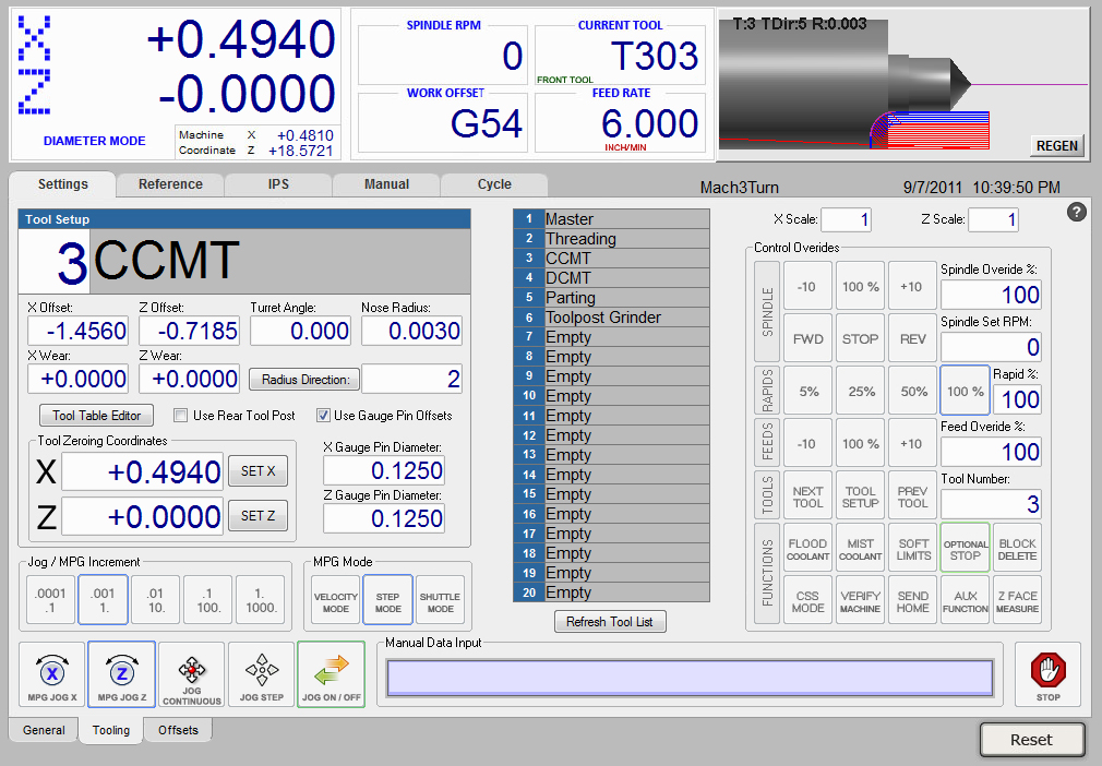

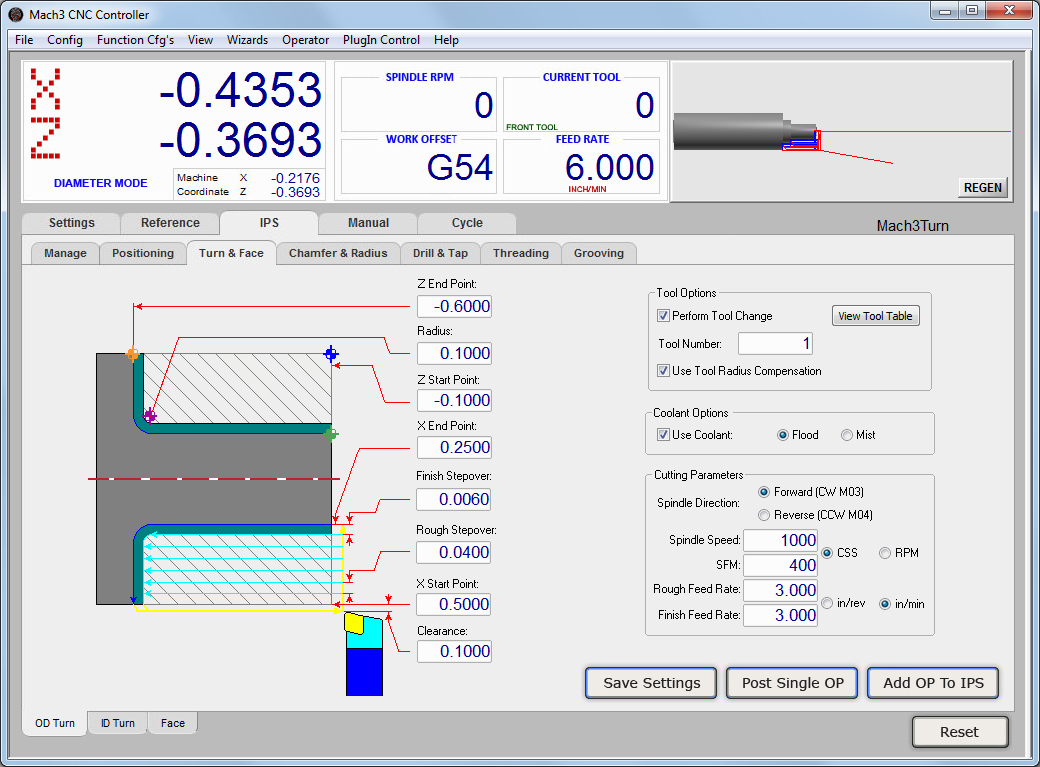

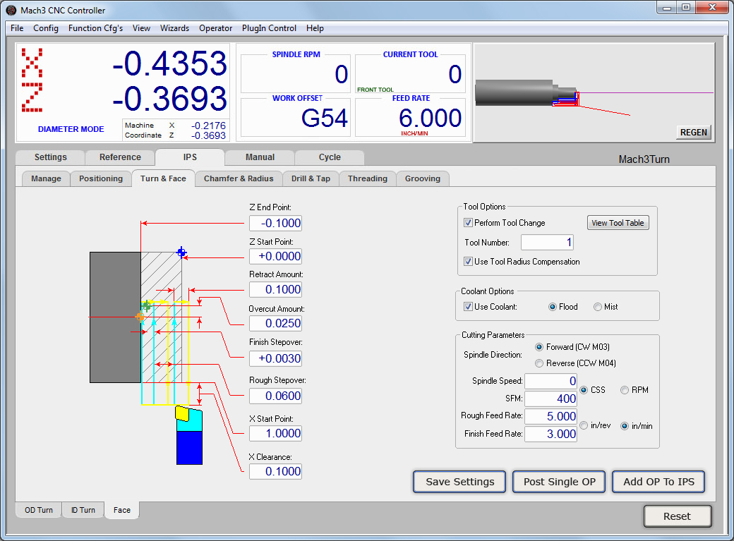

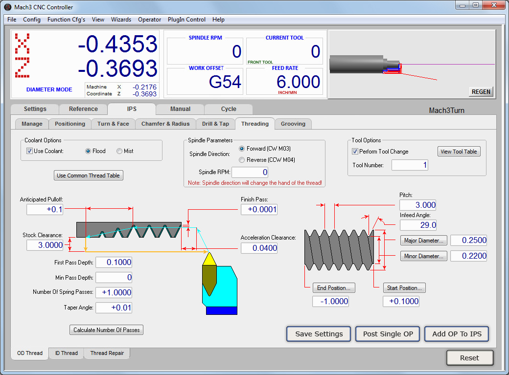

Wow. Just "wow".
Wes, what do you do?

wes,
would you be kind enough to send me the screens , i'll try and stick my neck out and make a linuxcnc variant based on gmocappy
i have a few ideas to add as well

dl.dropboxusercontent.com/u/75606622/Ins...%20Build%206.87a.zip
Pass = mach3ips
This is an installer for a windows box. Just install it and then you can look at the files. All images will be there. if you wanna see the screen install a demo of mach 3. There is also a screen editor available.
Here is just the images if you don't wanna install it...
dl.dropboxusercontent.com/u/75606622/IPS_IMAGES.zip
Let me know what you come up with or if you need any help.

Also those screens above are old ones. There are many additions and fixes since those were taken. The IPS system only worked with the modules that were created. The screen itself is finished for the most part. Like I say I gave up when I had Mach3 freak out and make my lathe do wild things. Thankfully it was only a 1 HP hobby lathe and not the 30 HP version I was planning to retrofit with it. That lathe was converted with Linux CNC
I would love to have this working under LinuxCNC but the learning curve to implement was just way too much time at the time.

Man oh man, oh man, oh man...
THIS ought to be good. If Gmoccapy had these graphics with its layout as customizable as it is, and combined with the features of ncgui... woo...
We'd basically have the LinuxCNC equivalent ( possbily better? ) of Mazatrol...
I can't wait to see how this goes.
Thank you Wes for the offering and thank you Dave for the undertaking. If I can assist in some way, holler.
