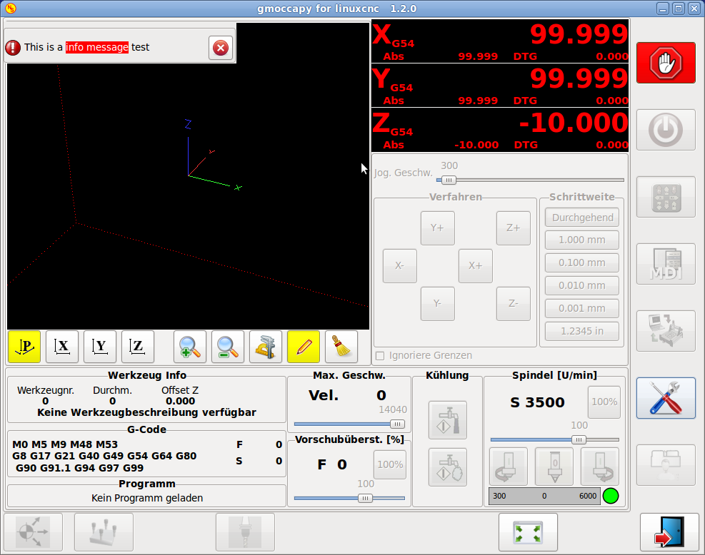

04 Sep 2014 20:03 #50781
by newbynobi
Replied by newbynobi on topic Gmoccapy - A new screen for linuxcnc
Hallo LAIR,
no it's your turn
I just pushed gmoccapy 1.2.0 to 2.6 branch, will push to master in a few minutes.
There are now:
3 message types that support pango markup language
this is a part copy from the new config gmoccapy_messages.ini
So please get the branch gmoccapy 1.2.0
and inform, if it is what you expected?
Norbert
no it's your turn
There are now:
# set up 3 user popup message dialogs
# the messages support pango markup language
# detailed information about the markup language can be found at
# https://developer.gnome.org/pango/stable/PangoMarkupFormat.html
# MESSAGE_TEXT = The text to be displayed, may be pango markup formated
# MESSAGE_TYPE = one of "status" , "okdialog" , "yesnodialog"
# status : Will just display a message as popup window, using the messsaging system of gmoccapy
# okdialog : Will hold focus on the message dialog and will activate a "-waiting" Hal_Pin OUT.
# Closing the message will reset the waiting pin
# yesnodialog : Will hold focus on the message dialog and will activate a "-waiting" Hal_Pin bit OUT
# it will also give access to an "-responce" Hal_Pin Bit Out, this pin will hold 1 if the
# user klicks OK, and in all other states it will be 0
# The responce Hal Pin will remain 1 until the dialog is called again
# MESSAGE_PINNAME = is the name of the hal pin group to be created
MESSAGE_TEXT = This is a <span background="#ff0000" foreground="#ffffff">info message</span> test
MESSAGE_TYPE = status
MESSAGE_PINNAME = statustest
MESSAGE_TEXT = This is a yes no dialog test
MESSAGE_TYPE = yesnodialog
MESSAGE_PINNAME = yesnodialog
MESSAGE_TEXT = Text can be <small>small</small>, <big>big</big>, <b>bold</b>, <i>italic</i> and even be <span color="red">colored</span>.
MESSAGE_TYPE = okdialog
MESSAGE_PINNAME = okdialog
Norbert
