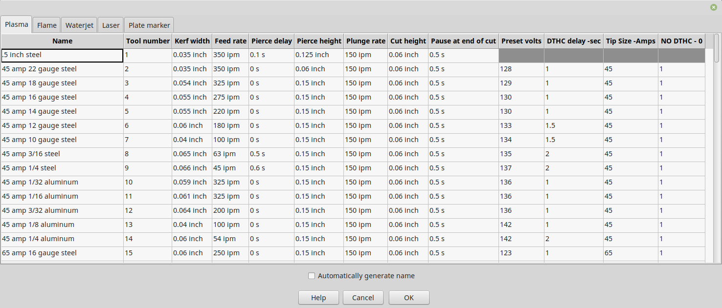

I've just started on my plasma gui the other day so not much for show and tell yet. There is a limit of 56 tools in the tool table but the numbers can be anything from 1 - 99999,
JT
Replied by BigJohnT on topic Another plasma component...
I was looking at that limit too. I do remember Andy or someone saying it had been increased. There is a note on the lathe page that there is a 99999 limit but I think pockets are involved. I think though most users will only have one machine so a smaller subset (but 56 won't go far). I was looking at my SQL stuff and wanted to try and add an auto incrementing tool ID to the cut chart select statement but not having much luck with SQLITE syntax. If I could do that, it would be much easier as the select statement could limit the data set (to 56)
It would be good if JohnT could share his sql and interface. I kinda think there needs to be a separate toolchanger module that shares the plasmac data.
JT
- Posts: 12166
- Thank you received: 4152
02 May 2019 12:38 #132528
Have to think about that.
What if we chose a data entity that had fewer values for a tool? It really is only the kerf width we need., 56 might work then. A quick loop in the setup .ngc file would establish the tool table with ID's and diameters/kerf widths depending on device units. So Plasmac looks up the ToolID that applies to the kerf width stored in the materials file.
Maybe the post processor passes plasmac the materials file ID via M67/M68. Plasmac retrieves the tool ID unique to that kerf width. Then after a dwell while plasmac completes the lookup, the Gcode does an M66 E0 L0 to retrieve the tool ID and saves it to variable #5399. Subsequently the gcode does a T #5399 M6.
Crazy, but my twisted brain says that might work!
Replied by rodw on topic Another plasma component...
The maximum number of entries in the tool table is 56. The maximum tool and pocket number is 99999.
JT

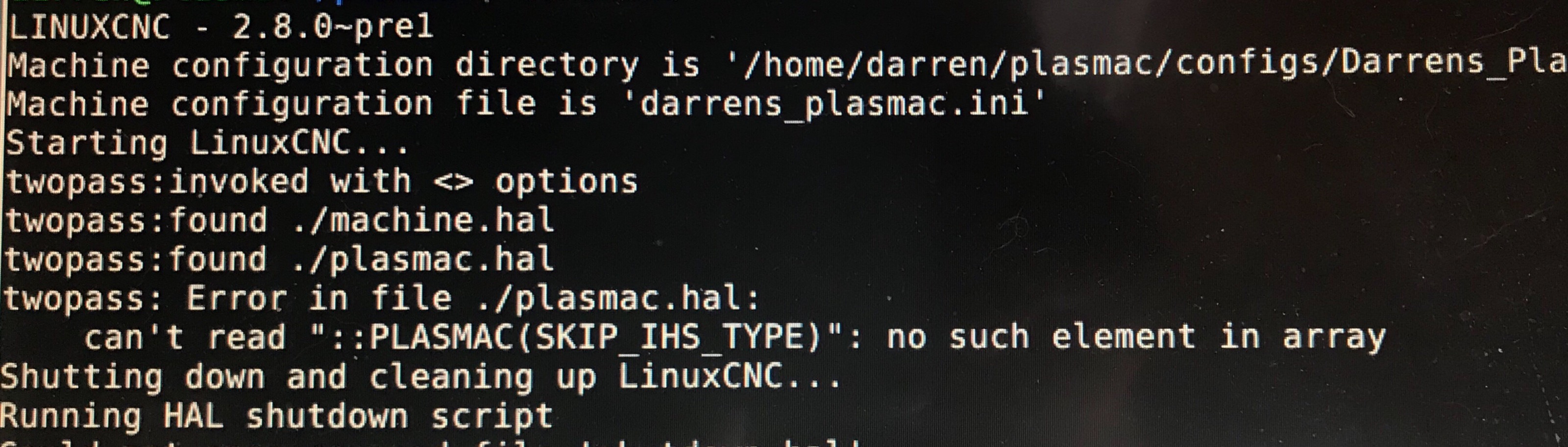

Well, after a full rebuild using Stretch, and a fresh clone of Plasmac, plus the ini file changes that were pointed out, I now have a machine that will jog, home, react to soft limits and limit switches.
I wanted to check probing, but when I go into the plasma config tab or the plasma run tab I am unable to enter any setting, the spin buttons do not work and any numbers that I can type in manually just revert to 0 or blank when I move to the next box or try to save.
I also notice that the squares gcode file does not load at start up. I also still have to comment out the IHS skip or I get an error, see attached screenshot.
I feel as though I have a path wrong or some files missing. I have tried a new clone and copy of the files to my Plasmac directory but it was still the same. I also used to have a test window pop up that I no longer see.
