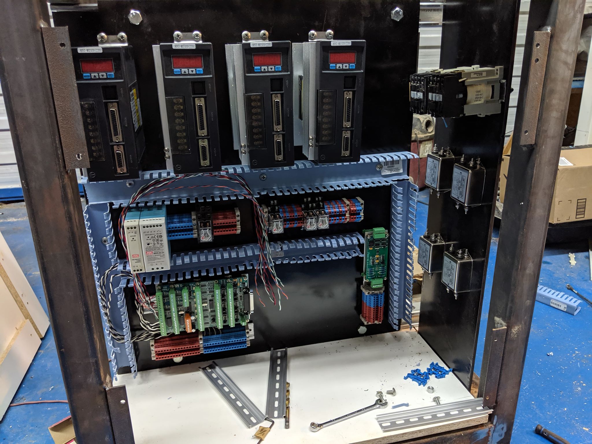

17 Jun 2019 16:01 #137135
by bevins
The 7i77 has opto couplers on them why would you need opto isolated relays?
I just got an isolated power supply for the ohmic stuff.
Replied by bevins on topic Bob's Plasmac Build
Looks good Bob. I wonder if its worth going with opto isolated relays rather than mechanical ones? I used the ones you have there and replaced most of them when I added ohmic sensing (becasue I had to by a pack of 5). The only one left disables the stepper drives on estop (Just becasue I've been lazy but I have the part here.).

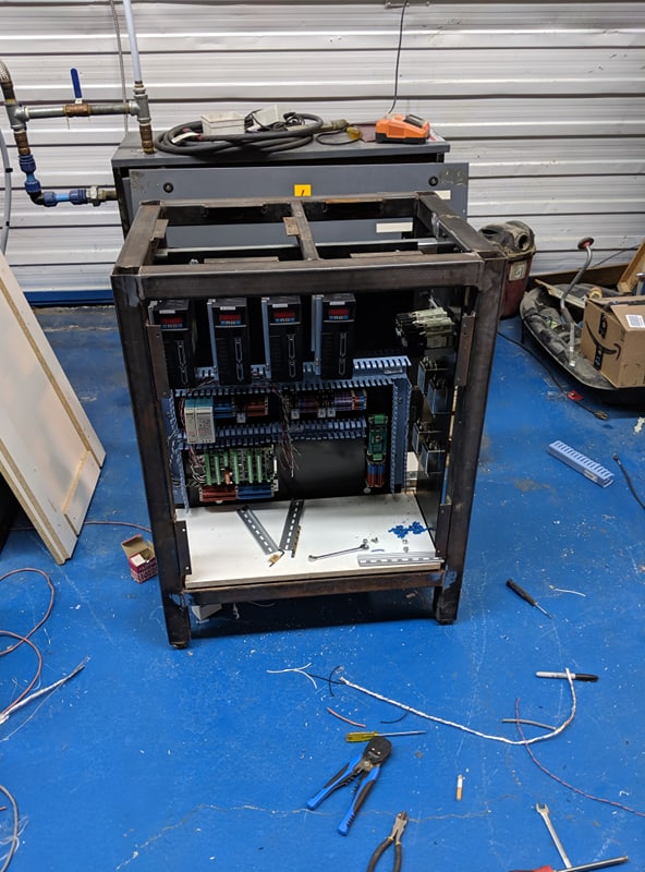

24 Jul 2019 00:03 #140368
by bevins
- Posts: 12161
- Thank you received: 4151
24 Jul 2019 00:25 #140370
Replied by rodw on topic Bob's Plasmac Build
Bob, looks good. So you are using the 7i77?
Whats a good sized 24V power supply for the Mesa card in your experience? I know I'm way over the top there.
- bevins
- Posts: 1947
- Thank you received: 338
24 Jul 2019 18:11 #140448
by bevins
Depends on how many relays and inputs but I always use a 2 amp 24vdc and never had an issue.

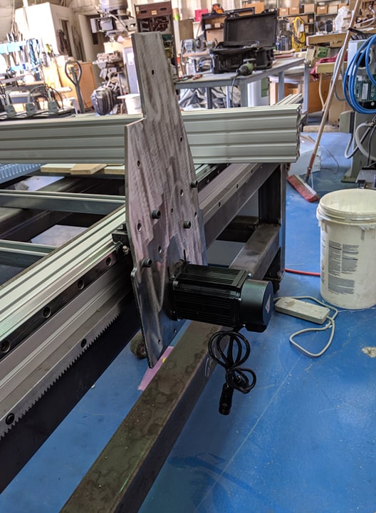

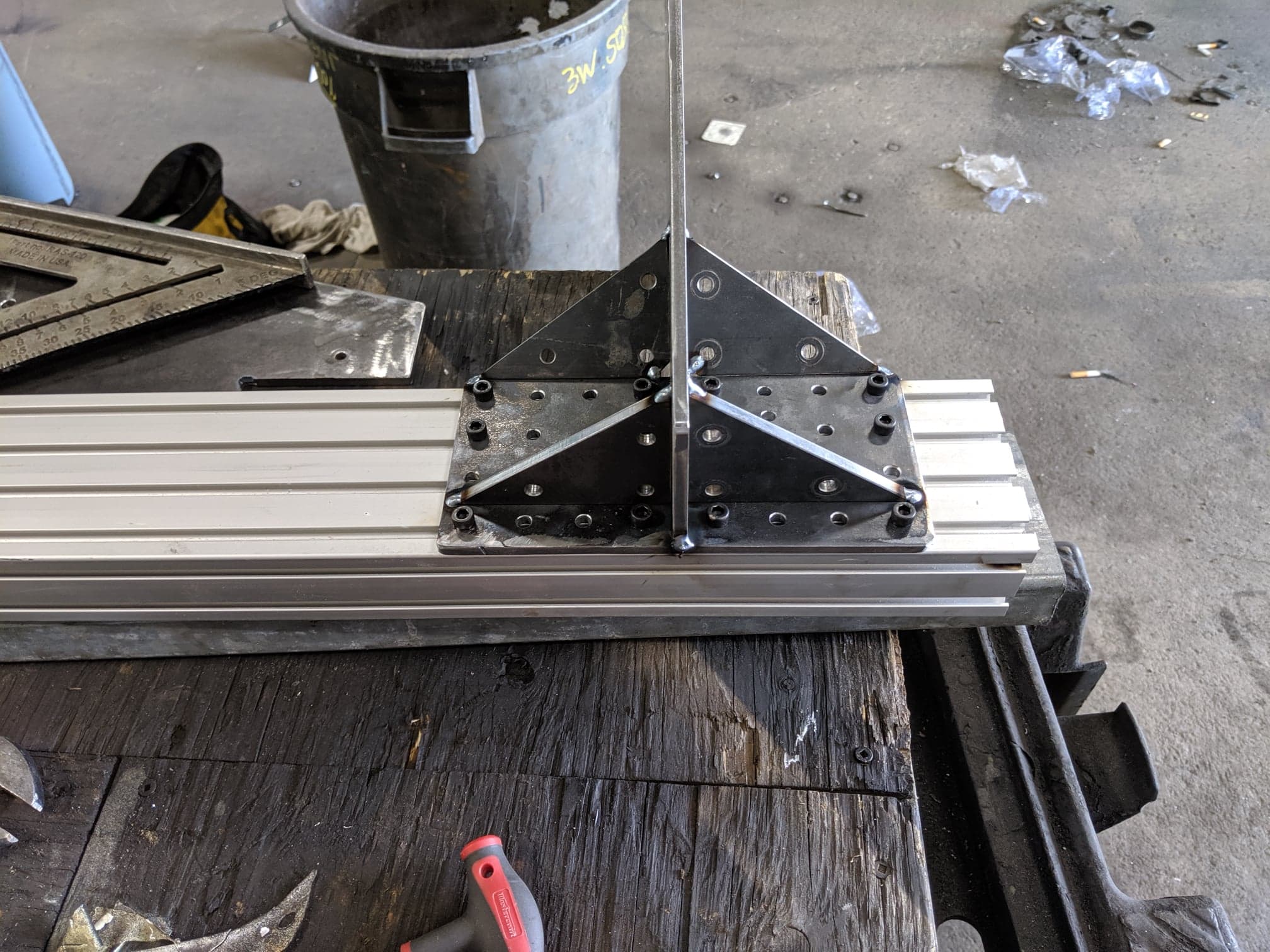

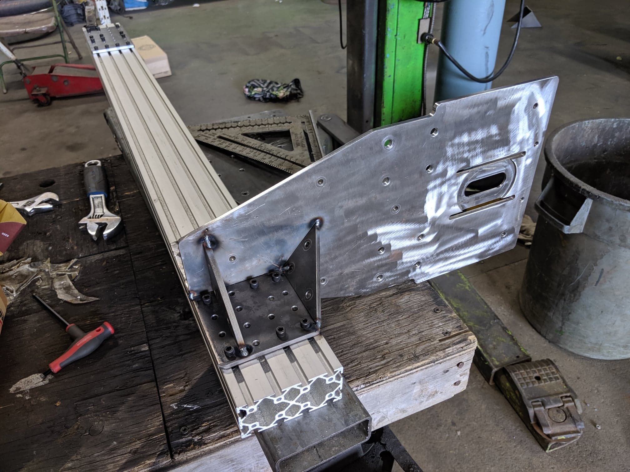

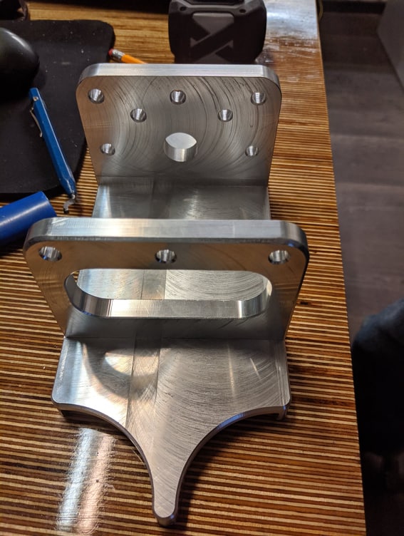

27 Aug 2019 12:18 - 27 Aug 2019 12:19 #143318
by bevins
Had a leave of absence fromt the project. Back at it now. Cut uprights for the plasma.
Need some ridge welding work to stiffen them up but turned out ok. Video of cutting it on my VMC.
Yeah yeah I know. Lots of chatter, but I am cutting 18" and only holding by 6" vise.....lol mill me some slack....lol
Last edit: 27 Aug 2019 12:19 by bevins.

02 Sep 2019 21:00 #143948
Looks good Bob. Hope you don't mind a couple of questions:
How thick is steel you are using?
So with those servos you use you don't need to bother with reduction drives? That sounds like it makes fro a much easier build over the steppers I used.
