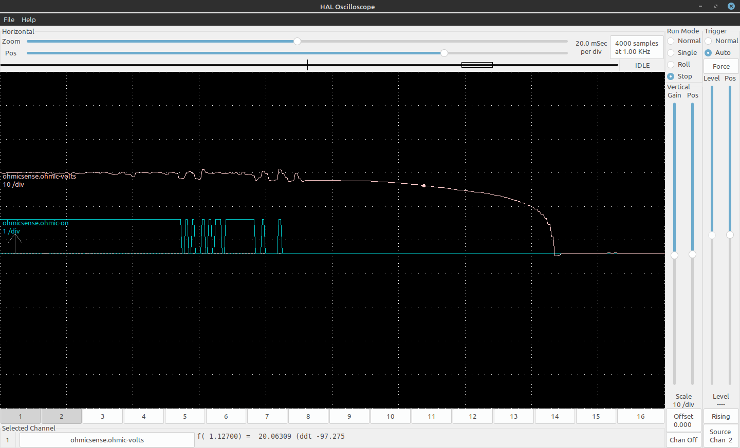

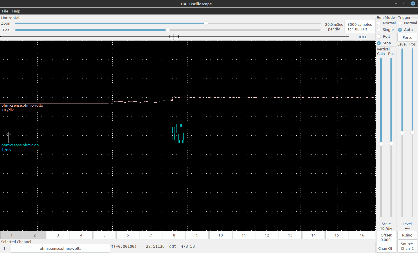

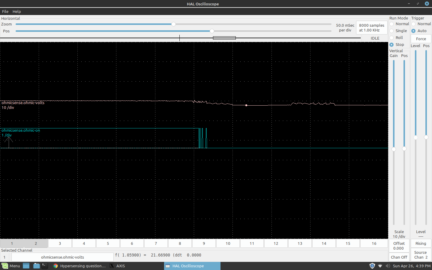

26 Apr 2020 20:46 #165697
by snowgoer540
Replied by snowgoer540 on topic Hypersensing questions

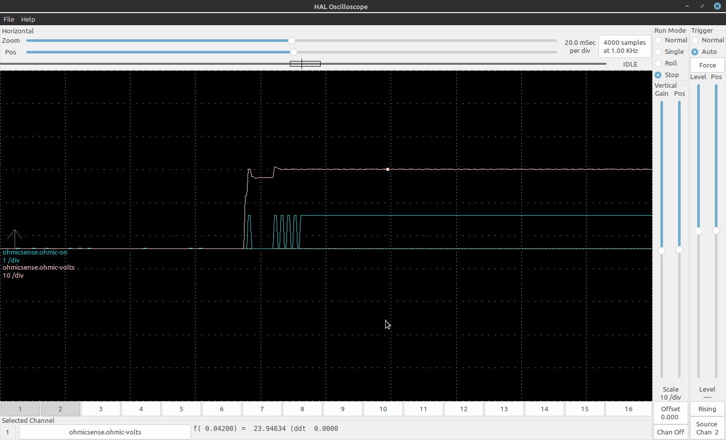

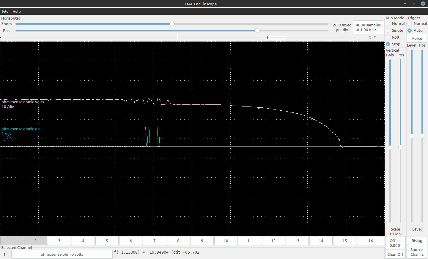

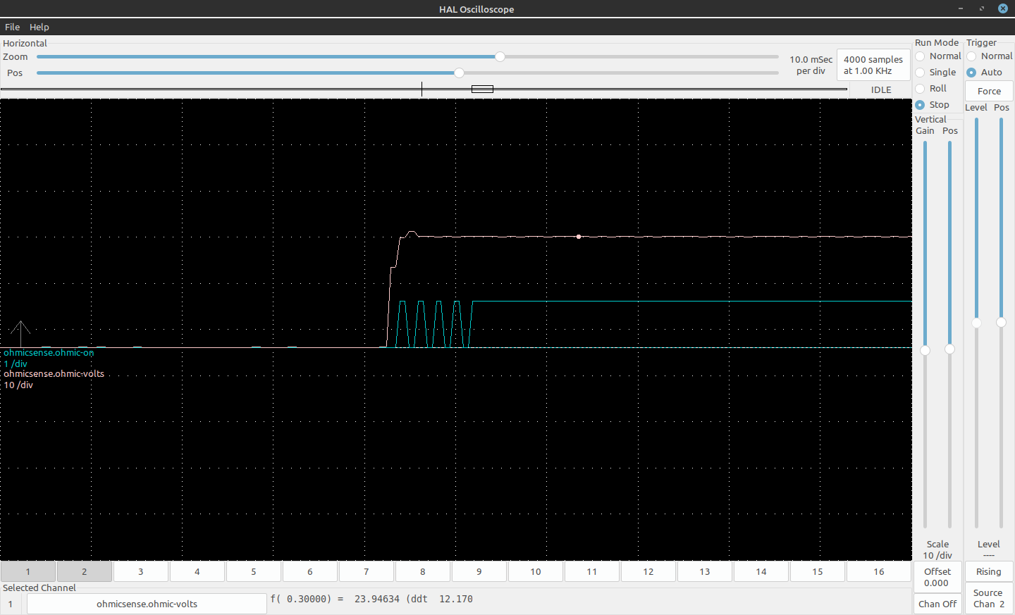

Ok, I finally have some data.
Probes 1 and 2 were done after i drenched the torch but pulsed the torch to blow the tip out.
Probe 3 was done with water splashed up into the torch, I opted not to clear it, just for "worst case".
My threshold is set to 23.5v and my powersupply is set to 24.5v.
Also, I kind of like the idea of pulsing the torch prior to starting the first probe if ohmic is enabled.
Let me know what you think of the pictures. I fought with halscope until I finally figured out what I was doing....I think. If I messed some data collection up, let me know and I'll grab new screen shots tomorrow.
Off to cook some steak now!
