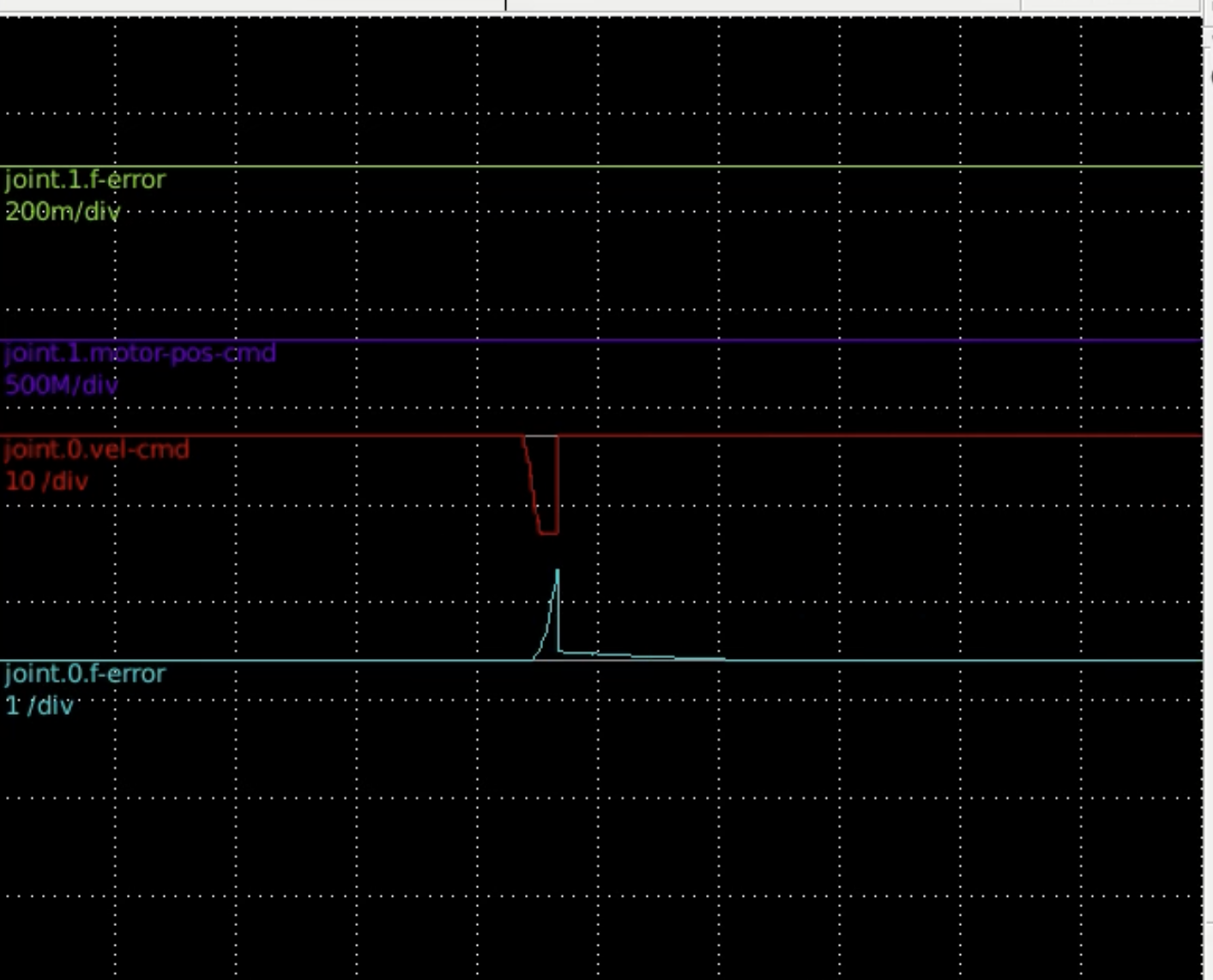

looks like a motor with a speed tracking issue, first Lcnc is driving up the Vout to get the requested speed, then the drive is responding with it's own loop by the looks of things. That sinusoid is a motor that is probably overdamped and does not have sufficient drive current.
So the damping is attempting to recover the overshoot after Lcnc see's the relative velocity is low and it drives up gain, then the sinusoid is probably lack of motor TQ to hold the required speed and it just keeps oscillating. The reason I wanted you to turn down the Lcnc pid loop control was to get exactly this kind of feedback.
So, what I would do
Turn up max motor current, turn down dampening. The ringing is indicative of excessive holding TQ in the motor driver. If you put your hand on it, can you feel it ringing when it is sitting still ? if so,
p04-03 &p04-04 internal clamp setup , and internal clamp amount, afaict these are your COMPensation values for zero request holding, reducing p04-04 should reduce the ringing.
. p05-10 & p05-11 these are the internal TQ limits, what are these settings ?
p06-40 is the input gain value, this will matter once we know the values for the motor max speed, and the lead screw pitch. Given that you have been able to use the lathe and it seems to be making parts that are the correct size, it seems like the encoder counts are correct for the pitch.
Do however need to calculate you Velocity command loop maximum speed to get the gain scaling correct for the drive and Lcnc

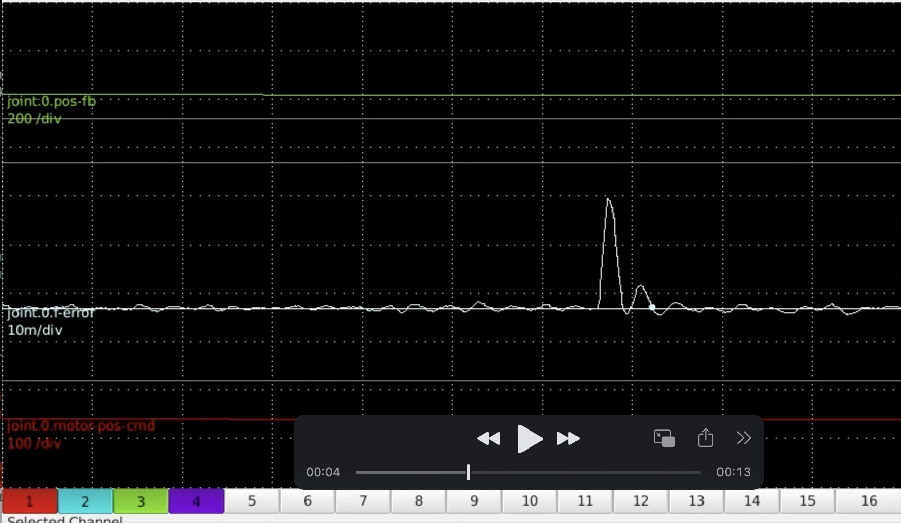

RotarySMP post=259493 userid=2917Here is a zoomed in version of the plot at a change in directions...
So, what I would do

"The reason I wanted you to turn down the Lcnc pid loop control was to get exactly this kind of feedback."
Sorry, so I should reset LinuxCNC down to P0 FF1, and try and capture the V_Out plot as the motor jerks on a motion command, before the joint errors out?This is it here:
"Turn up max motor current"
I went through the motor parameters. There is no driver variable to set Max current. Only the rated current. Currently 2.8A, I could up that to 3A, as it says on the motor nameplate.Here are the P00 motor parameters as read into the driver:
Here are the P04 parameters as set by the autotuning.

"The ringing is indicative of excessive holding TQ in the motor driver. If you put your hand on it, can you feel it ringing when it is sitting still ?"
No, I feel nothing, also the Osci plot when no motion is commanded is completely flat.

sorry Mark, was typing on my phone. so if motor speed is 3000rpm and reduced 2:1 motor speed at the lead screw is a whopping 1500rpm , so 1500/4 is 375mm minute, or .35m/min or 5.8mm/sec
Try this first, turn your max motor speed upto 6000rpm, on both axis.
see if that resolves or improves the makeup gain situation. recalculate your velocity's from leadscrew pitch enter those values in your ini file
