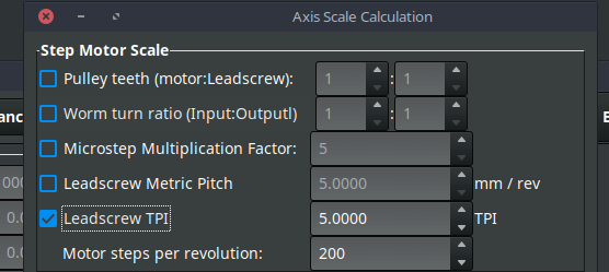

Found it I changed it on the new configurator file it created and it still does not travel the 1 inch ask it to move. It goes 7.25 inches. Changed the stepper scale to the same I have on the wizard and where I test it and it moves 1 inch. Any other place I need to change it?

by phillc54
Replied by phillc54 on topic New Project with Mesa 7I96 and THCAD-05
No, that should do it.

Ok well I give up I might have to start all over again delete the plasmac machine and start with base and try it and hope it works not sure why they have mm in the calculation tab when you choose inches when your entering it on the first tab of the wizard.

- TexasCNC
- Posts: 373
- Thank you received: 10
13 May 2021 05:42 #208708
by TexasCNC
Replied by TexasCNC on topic New Project with Mesa 7I96 and THCAD-05
Yes I did do that when you mentioned it and I tested it and it was way off. I know the number I want to enter is right on as it working on my other machine same rack and pinion and motors. Only difference from that machine to this new one is the control board.

14 May 2021 22:42 #208867
by TexasCNC
So I rebuilt and started all over and finally got it. Me changing the stepper scale on the ini files was not working so started all over and did it correct and finally got it thanks Phill. I have a question so how does the thcad work as far imputing the voltage? Do I put the voltage that my manual says intro he config panel for the material I am cutting or am I putting another voltage since I am getting divided voltage out of my plasma?
