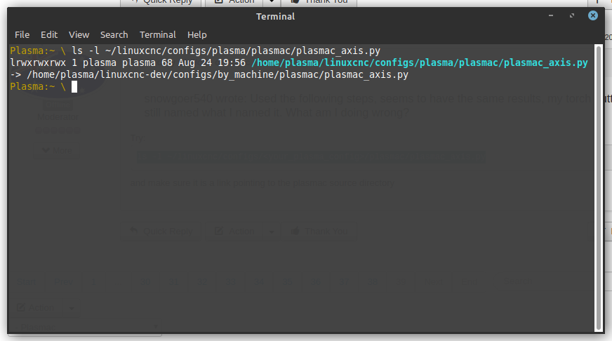

Used the following steps, seems to have the same results, my torch button is still named what I named it. What am I doing wrong?
Only line I didnt use was:
Replied by snowgoer540 on topic Feature Request
You may need to do a make clean after switching branches then to be safe redo the ./autogen.sh and ./configure --with-realtime=uspace
Edit: I did think of renaming them like you did but then someone will complain that they press Torch On and it doesn't turn on...
> cd linuxcnc-dev/src
> git checkout 2.8
> ./autogen.sh
> make
> sudo make setuidOnly line I didnt use was:

Try:Used the following steps, seems to have the same results, my torch button is still named what I named it. What am I doing wrong?
ls -l ~/linuxcnc/configs/<your_plasma_config>/plasmac/plasmac_axis.pyPlease Log in or Create an account to join the conversation.

I guess I could just delete the directory and start again?
It's not a huge deal, but I'd just be worried I wouldn't pick something up for some reason.
